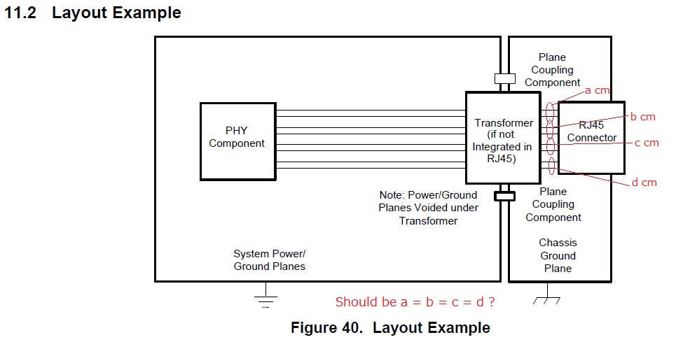

DP83867 can support four pairs MDI interface with magnetic. Each pairs of TD_P and TD_N trace length should be same. Should we keep all four pairs trace length be same?

I can find below comment but cannot find each pairs length.
Within the differential pairs, the trace lengths must run parallel to each other and matched in length. Matched lengths minimize delay differences, avoiding an increase in common-mode noise and increased EMI.
Please see below fig.
My question is if we should all of a, b, c and equal?
Uchikoshi
Thank you for your reply.
Can I ask why they are to be equal?
There are some restriction to trace these to be equal so we want to know the reason.
Uchikoshi
Hi Uchikoshi-san,
This is to keep the signal delay same across the pairs.
