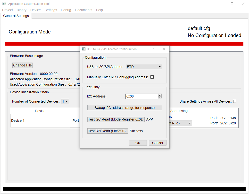

I have some questions about your tool "Application Customization Tool".
I switch off all SPI lines of S1 switch,
and then execute "Test SPI Read" of "Configure I2C/SPI Adapter Settings".
"Test SPI Read : Success"
How can operate to test SPI during off-state of all SPI lines on S1 switch?
Also, I don't enter correctly I2C Address, How the test is Success during off-state of all SPI lines on S1 switch?

  • Thank you for reply.
    But, I have found strange thing.
    So, I have additional test about that.
    First, I unpluged Micro-B USB Cable from TPS65987EVM.
    And then, I executed "Test SPI Read (Offset :0)" and then the result was "Exception Encountered".
    I think It is very nature result.
    Second, I switched off all lines(I2C & SPI) of S1.
    And then, I executed "Test SPI Read (Offset :0)" and then the result was "Success".
    How it operates although I disconnect path from FTDI <-> TPS65987D by S1 Switch all off???
    So, I guess that "Test SPI Read (Offset :0)" is testing a EEPROM (U7 of PSIL060A(001) -TPS65987EVM's schematic) for initial setting FTDI.
    Is it right??
    Please check and confirm correct fact.
  • Hi Chanwook,
    Can you confirm that you are using the latest version of the TPS6598x Application Customization GUI from TI.com?
    Your statement is correct from your previous post. Are you having any issues with the GUI?
    Eric
