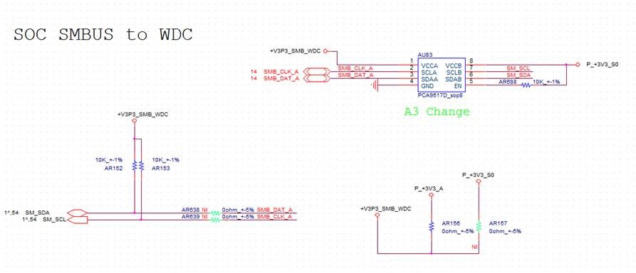

We would like to know TCA9517DR SOIC could use on same voltage? (3.3 to 3.3)
If couldn't, have others P2P solution can share?
Our application as below
