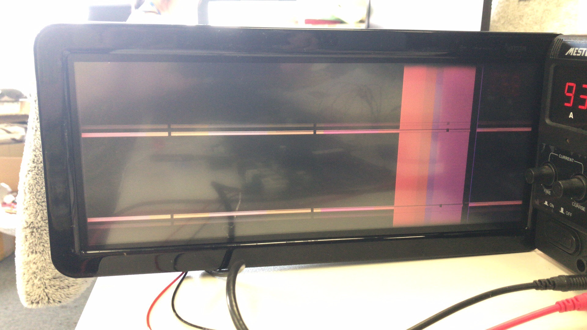

Our customer who use TI949+TI948 and test the BIST mode normally.
The resolution of the panel is 1920*720,and the registers configuration is as following:
patternset 03 2        // 100MHz
patternset 04 c0      // total frame 1984*792
patternset 05 87
patternset 06 31
patternset 07 80     //active frame 1920*720
patternset 08 07
patternset 09 2d
patternset 0a 08    //HW 8
patternset 0b 07    // VW 7
patternset 0c 0c    // HBP 12
patternset 0d 08   // VBP  8
echo 04 > /sys/kernel/debug/ti949/65
echo 35 > /sys/kernel/debug/ti949/64
Enable the internal pattern Generator, it appears normally.
But when close the pattern generator,  the panel appears abnormal.
Could you please give me some analysis?
