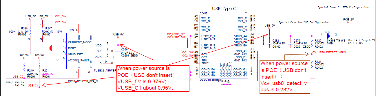

In our system there are 2 power supply source, 1 is powered by USB, 2 is powered by POE.
In current system design, we use "CV_USB0_DETECT_VBUS” to detect USB insert or not.
If I powered by POE, the system could work. Theoretical "USB_5V(VDD Pin)” should be 0V, but there is slightly leakage due the system is powered on. Therefore, the value that I detect "USB_5V(VDD Pin)” is 0.376V, and the value "USB_C1(OUT2 Pin)” is 0.95V;
But according to Datasheet Page.4, OUT1 or OUT2 Max Voltage value is ”VDD + 0.3”.
In our case, 0.95V>0.376V+0.3V. Would it damage to ” TUSB321AI” ?
    There  is some potential for TUSB321AI to be damaged in this condition. TUSB321AI could also have some potential to be back-powered in this case which could cause internal state machine issues. Is there any voltage on USB_CD as well? I believe that TUSB321AI may be back powered in the POE case causing OUT2 to be in a bad state. Is there anything on USBC1 that could generate the 0.95V?
  • Dear Sir:
    You say " Is there any voltage on USB_CD as well?", but I don't find the "USB_CD", Could you tell me where is the USB_CD??
    Because in our system there are 2 power supply source, 1 is powered by USB, 2 is powered by POE.(Alternative)
    So When powered by POE, at this time the system is normally powered. And  the voltage value on "USB_C1(OUT2 Pin)” is 0.95V, "USB_5V(VDD Pin)” is 0.376V
    So you think that in this situation, the  TUSB321AI will be damage, is it??
    Thank you.
    My apologies there was a typo. The message was refereeing to USB_C. There is a potential for damage but I cannot guarantee that TUSB321AI will be damaged in this case. I believe the reason you are seeing the voltage on USB_C1 is because TUSB321AI is being partially pack powered by POE.
  • Dear Sir:
    The voltage of USB_C0(OUT1 Pin) is the same to USB_C1(OUT2 Pin), about 0.95V.
    So you mean if our system powered by POE, and voltage of VDD Pin (USB_5V) is 0.376V, OUT1 or OUT2 voltage is 0.95V.
    It may cause TUSB321AI damage, is it??
    So you don't recommend this design, right??
    Thank you.
    For both questions, this is correct. I recommend using a stronger blocking diode or if possible use a power switch to disconnect USB_5V form POE12V.
