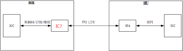

Dears:
Do have below serializer or Recommend solutions? Thanks!
RGB888/LVDS/HDMI to FPDLINK III, pair with DS90UB954.

Hello Cary,
We do not have such a solution which can pair with 954. I would suggest using DS90UB940-Q1 on the deserializer side for MIPI CSI-2.
A few compatible serializers would be DS90UB949/929-Q1, DS90UB947/927-Q1, or DS90UB925-Q1

Dear Casey McCrea,
Thanks for you support!
But deserializer DS90UB954 can not be changed. We need to pair with it.
Can you help to provide the soluiton that use two chips to achieve this function? Thanks!
Hello Cary,
I would recommend using DS90UB949/929-Q1, DS90UB947/927-Q1, or DS90UB925-Q1 depending on the box video output type and then connect the serializer to DS90UB940-Q1 which outputs CSI-2. Then you can feed the CSi-2 output from 940 into DS90UB953-Q1 which can then feed 954.
For example:
HDMI -> 949 -> 940 -> 953 -> 954
LVDS -> 947 -> 940 -> 953 -> 954
