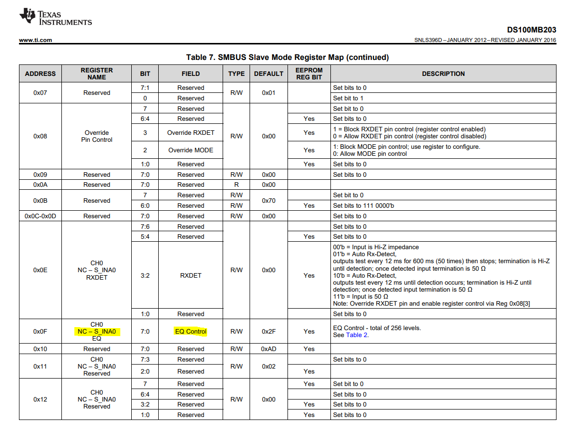

1. The customer want to know what "NC" among the EQ control register name means.
CH0 NC – S_INA0 EQ
CH1 D_OUT0 – S_INB0 EQ
CH2 NC – S_INA1 EQ
CH3 D_OUT1 – S_INB1 EQ
CH4 D_IN0 – S_OUTA0 EQ
CH6 D_IN1 – S_OUTA1 EQ
CH7 NC – S_OUTB1 EQ
2. There is no EQ control register for CH5 NC – S_OUTB0 on the data sheet.
3. Could you let me know the details of how to set up EQ & DEM (De-emphasis) with customer's board.

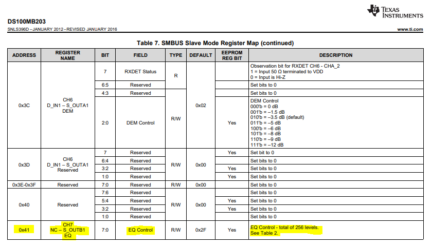

    Jonathan Q : I still have doubts about RxEQ function(CH5 and CH7). There is no RxEQ function for CH5, but there is RxEQ function for CH7 as can be seen below data sheet.
     You mean, there is something wrong in the data sheet?  May be typo?

    1.  The register names always contain an Input-Output or Output-Input pair.  The left side of the diagram is called out first.
    This makes the first channel CH0:  NC - S_INA0
    Note:  This channel will control S_INA0 RxEQ only.  There is no output associated with CH0 registers.  To control D_OUT0 you will need to use the registers associated with CH1:  D_OUT0 - S_INB0
    2. There is a register for CH7 EQ shown in the datasheet, but this register is not connected to the DS100MB203 datapath.
