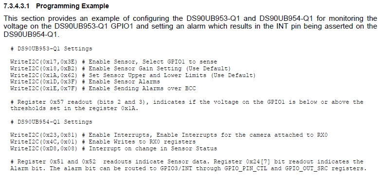

Could you please share DS90UB953/DS90UB954 sample code as description in DS 7.3.4.3.1.

Hello Lin,
I'm not exactly sure what you are looking for? This is the code we used and it can be run with our Analog Launchpad program. We do not provide Code Composer Studio code or any other processor specific codes.
Casey
Hello Kevin,
Please find sample codes in the following folder when you install our Analog Launchpad Program: http://www.ti.com/tool/ALP
C:\Program Files (x86)\Texas Instruments\Analog LaunchPAD v1.57.0010\PreDefScripts\DS90UB954
