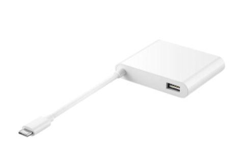

  • Hi Adam,
    We need cell phone provide VBUS to docking station via RD=5.1k pull down. Docking station is like below.
    If the docking station is presenting Rd of 5.1k ohm, then when a device is connected that can present an Rp, an implicit contract will be negotiated between the two devices and 5V will be presented on VBUS. If you know that the dock is presenting Rd, but when the phone is connected VBUS does not go to 5V, then you can infer that the phone is not presenting an Rp so the problem would be on the phone being connected and the dock.
