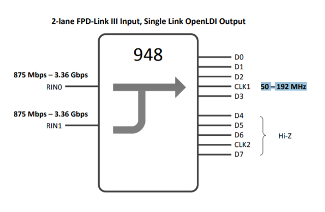

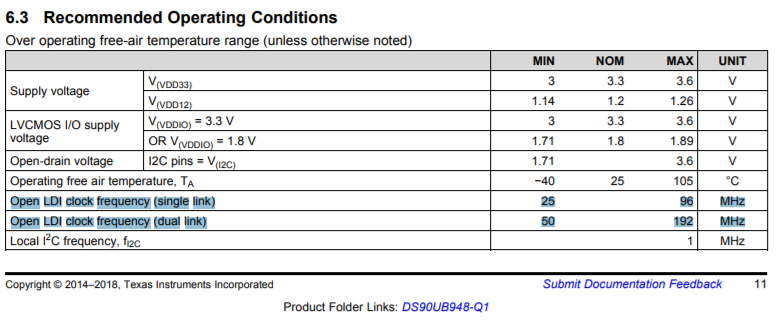

Hi team,
Could you please help to confirm on below problem regarding to ub948, thanks!
1. As the spec show, ub948 single link output condition, the max OLDI Clock is 96MHz. While in bleow application condition, the PCLK range is 192MHz.
Could you please help to check on it?
2. ub948 internal have 1 PLL for both FPD LINK input, or total 2 PLLs, each PLL for one FPD Link input?
