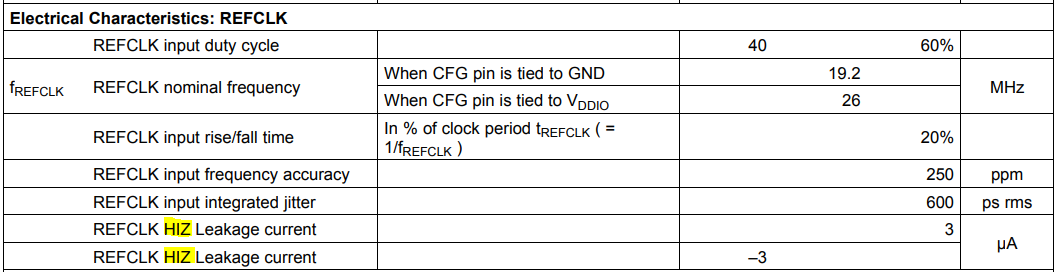

TUSB1210-Q1: Current Consumption on REFCLK pin when active
Part Number: TUSB1210-Q1
Hi Team,
How much current will the REFCLK pin consume when it is active? I see that there is a specification in the datasheet for 3uA when in HI-Z, but there is no spec for when it is active.
Any insight you can provide would be greatly appreciated. Thanks!
