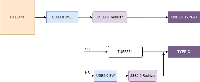

    First of all the customer system block diagram is shown below:
    1. Between the USB hub IC there are two USB switch device that adds 6~8ohm resistance in data line.
    2. This USB2.0 re-driver is work with a full function Type-C interface in TV side.
    3. Customer oringinal boost lever is 80mV, I have tried 40mV but still not work in ThinkPad notebool and severals other brands notebook
    4. If add a Type-C to Type-A plug and connect the notebook through Type-A port the connection is success in ThinkPad.

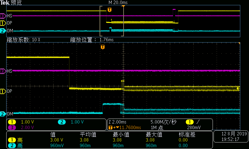

    1. USB high-speed handshake is success in the begining even in the ThinkPad. (Shown in Picture.2) Idle states, 0.8V K/J chrisp and 0.4V K/J chrisp is obersvered. But the communication will stop.
    2. After several data package TUSB212 exit high speed mode and the HS Flag is turn from high to low level. (The Pink waveform)
    3. Before the device stop communication and exit high speed mode, the differential pair lever is 800mV with 80mV DC Boost Gain and 640mV with 40mV DC boost Gain. But both the MacBook/Mate Book(Which could connect normally) and ThinkPad the voltage level is the same. I understood that 625mV differential voltage may lead to communication stop but i don't know why it work in MacBook and MateBook.
    I also want to konw if the differtial voltage level is too high and the boost gain is already in minimum configuration 40mV, how to fix such issue?
    As two D+ line could simplely short together in Type-C interface or otherwise we could leverage a MUX to controll the data line.
    Are two D+ line short together in note book side will lead to this issue?
