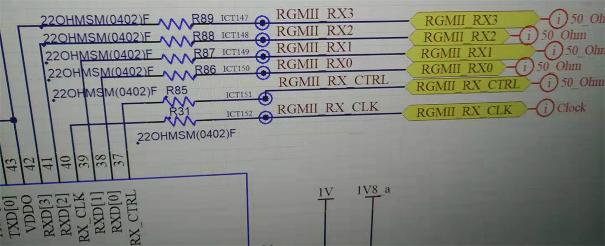

DP83825I: DP83825i traces impedance
Part Number: DP83825I
Hi  Expert,
In the 11.1.1 signal traces section, it's said that all single traces should be 50 Ohm single-ended impedance. In customer's application, they add a 22 ohm resistor at the trace, just as in the below figure. I want to know if the 22 Ohm resistor are included in the 50 Ohm impedance.
