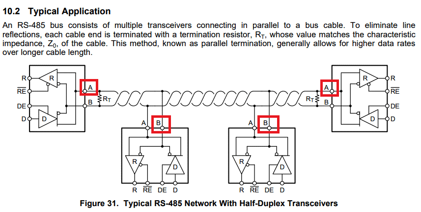

Hi Sirs,
Sorry to bother you.
In THVD1450DR datasheet, we found transceiver output A connection is not consistent (A or B).
Could you help to confirm the connection is A-to-A and B-to-B?
