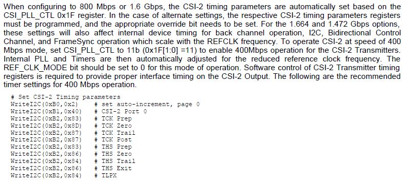

  • Hi Qinghua,
    I see on your code you are setting the CSI rate to 400Mbps. When you set it to 400Mbps you would need to set additional registers:
    The resolution and payload look correct to me. Once you set the above registers, could you check register 0x35[0] to make sure there's valid CSI data coming out of the port? If 0x35 = 1 and you still aren't able to capture the images, that means there's probably something on the processor side that isn't able to capture the video.
