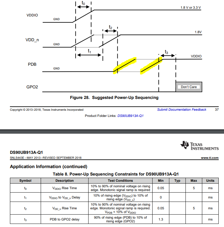

Are there any regulations PDB rise time, as this information is not available in datasheet?

There is no requirement for PDB rise time. Please just ensure that the rest of the power sequence above is observed.
