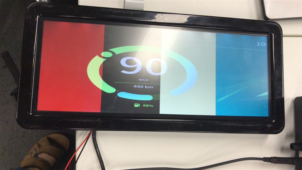

Hi Team,
A picture output through HDMI shows only the left half. How to locate the problem?
MAPSEL=1
OUTPUT_MODE=Single OLDI output

Hi Amy,
I will need more information such as your clock, your strap modes for both the SER and DES, the image format, etc.
Also can you first try running PATGEN and see if the image display correctly? Try PATGEN first using internal timing, then try external timing and make sure the panel specs are all correct.
