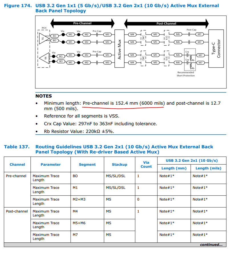

Could you please help to re-confirm the trace length that our TUSB1046 can support or not.
The case:
  1. PCH to MUX for USB3.1 Gen2 :3000mil(Pre-Channel)
  2. MUX to Type C con :1000mil (Post Channel)
  3. DP1.4 (from GPU) to MUX :10000mil.
The question from customer the Pre-Channel is too short and under 6000mil, would it be the impact that 1046 can not support it?
BTW, please refer to the Intel requirement which provide from customer.
