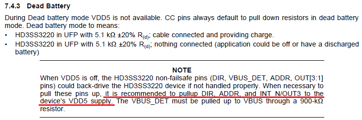

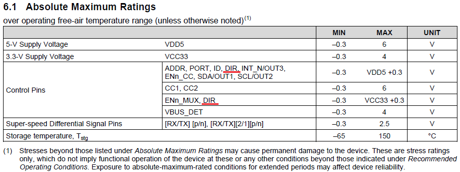

There is two DIR pin description in Absolute Maximum Ratings.
Which is correct?
I believe "VCC5 + 0.3V" is correct because of the following.
Is my understanding correct?
