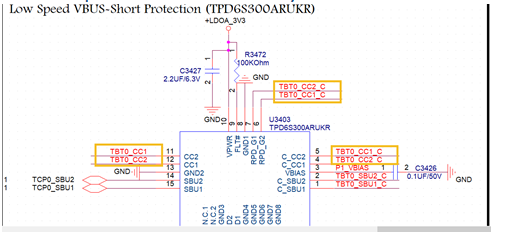

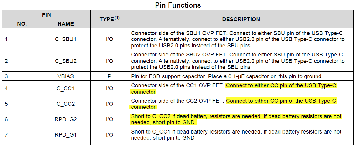

TPD6S300A: Swap CC line
Part Number: TPD6S300A
Dear Team,
May I know could we swap CC1 and CC2 like below figure?
Thank you.
