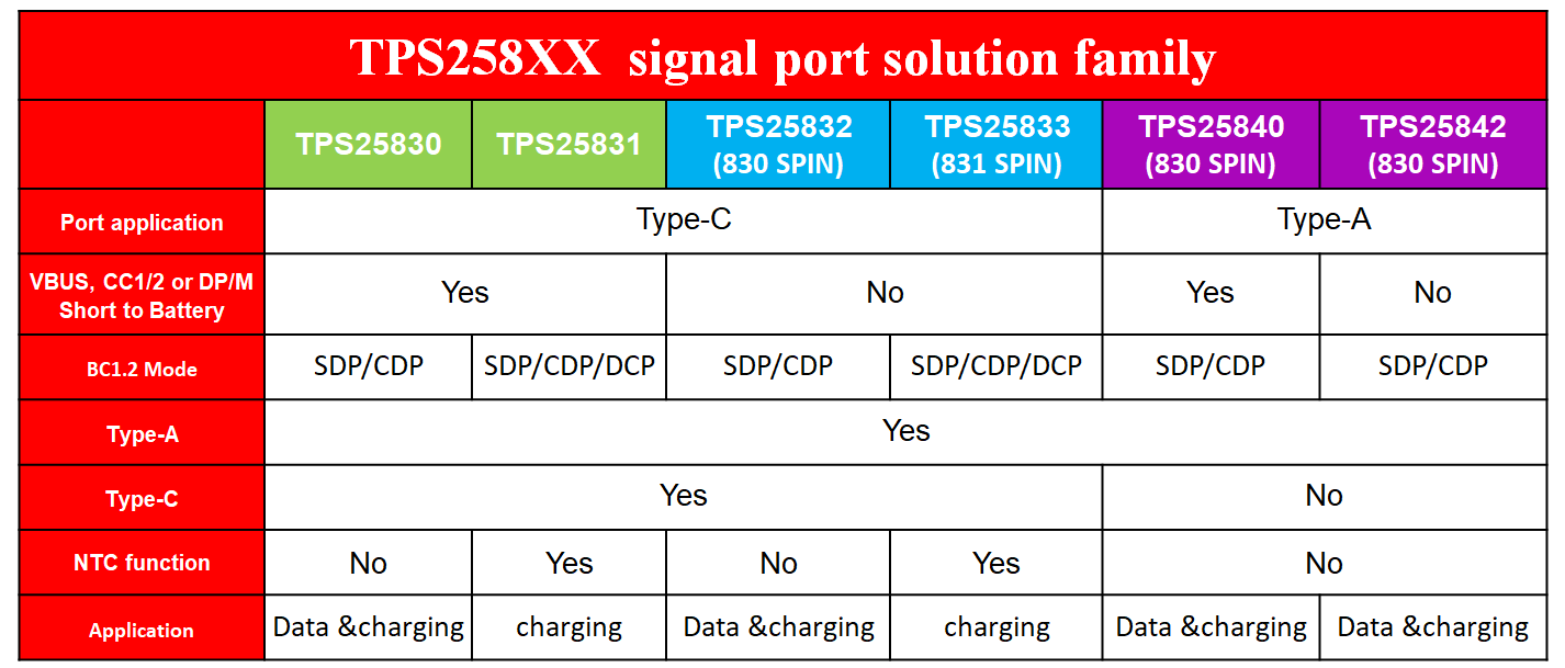

Hi Sir
May I know what's different for TPS25830/1/2/3 ?
