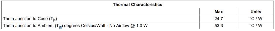

Dear Sir.
Good day.
My customer wants to use the DP83630. Can you please provide the following "TBD" data? Thanks for hep~
Hi AJ,
Please refer to this thread: https://e2e.ti.com/support/interface/f/138/t/763689?tisearch=e2e-sitesearch&keymatch=DP83630
Hung Nguyen
It is confirmed that Tjc for this type of package is 4-5 C/W, which is based on similar product DP83620.
Hung Nguyen
