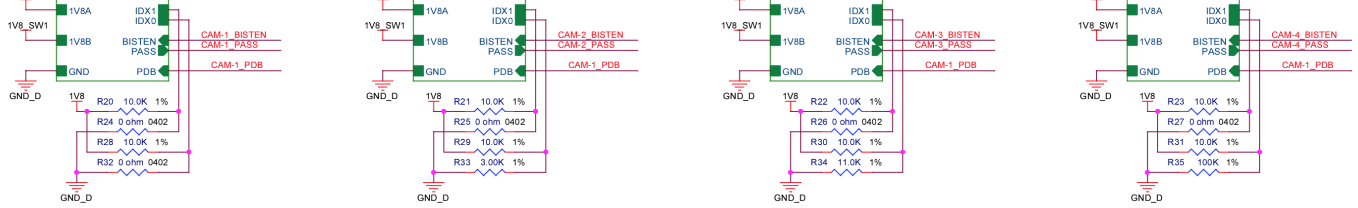

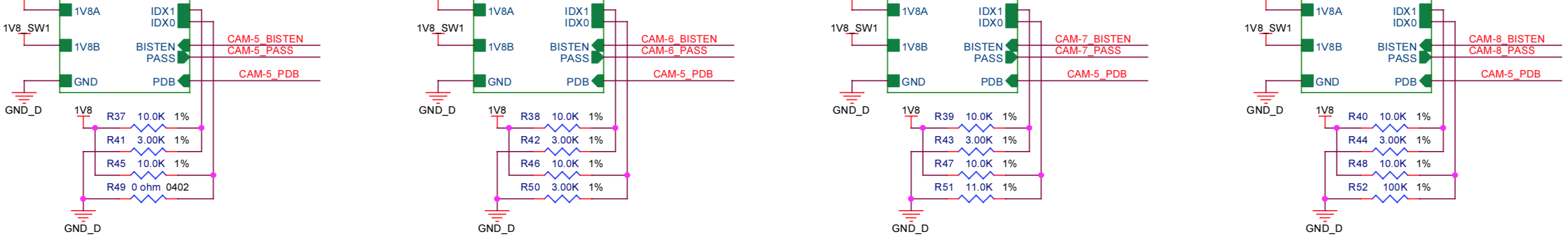

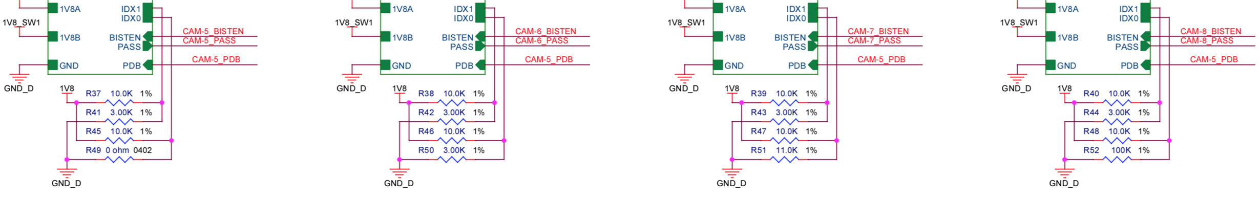

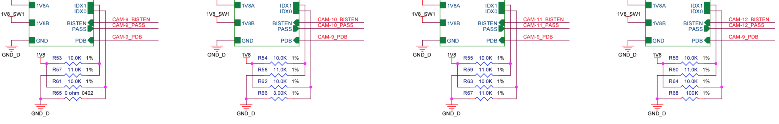

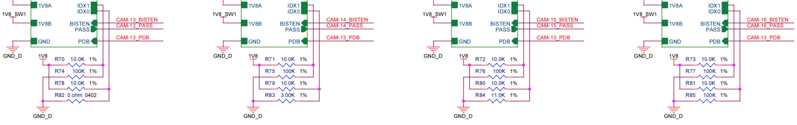

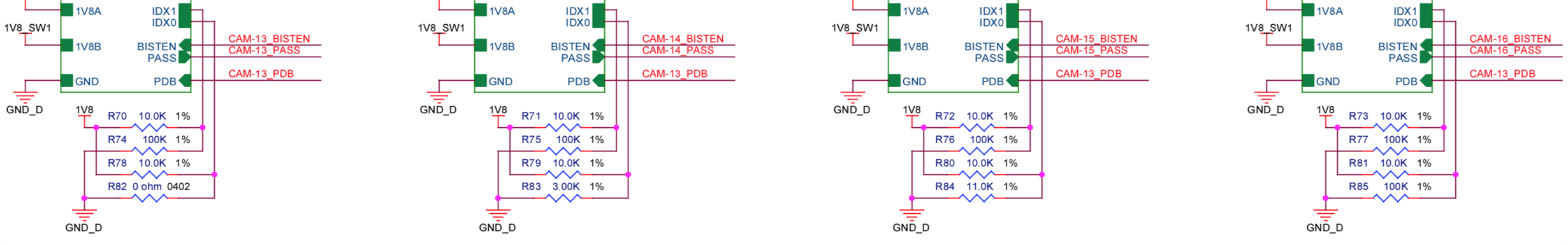

  • Hi Steven,
    Please see attached for screen shots of the deserializer I2C configuration resistors.
    -Cousins
  • Stephen, Casey,
    I've verified that all 16 devices do have different voltages on all of their voltage deviders for the IDx[0] and IDx[1] ( validating that the CM did not populate the board incorrectly ).

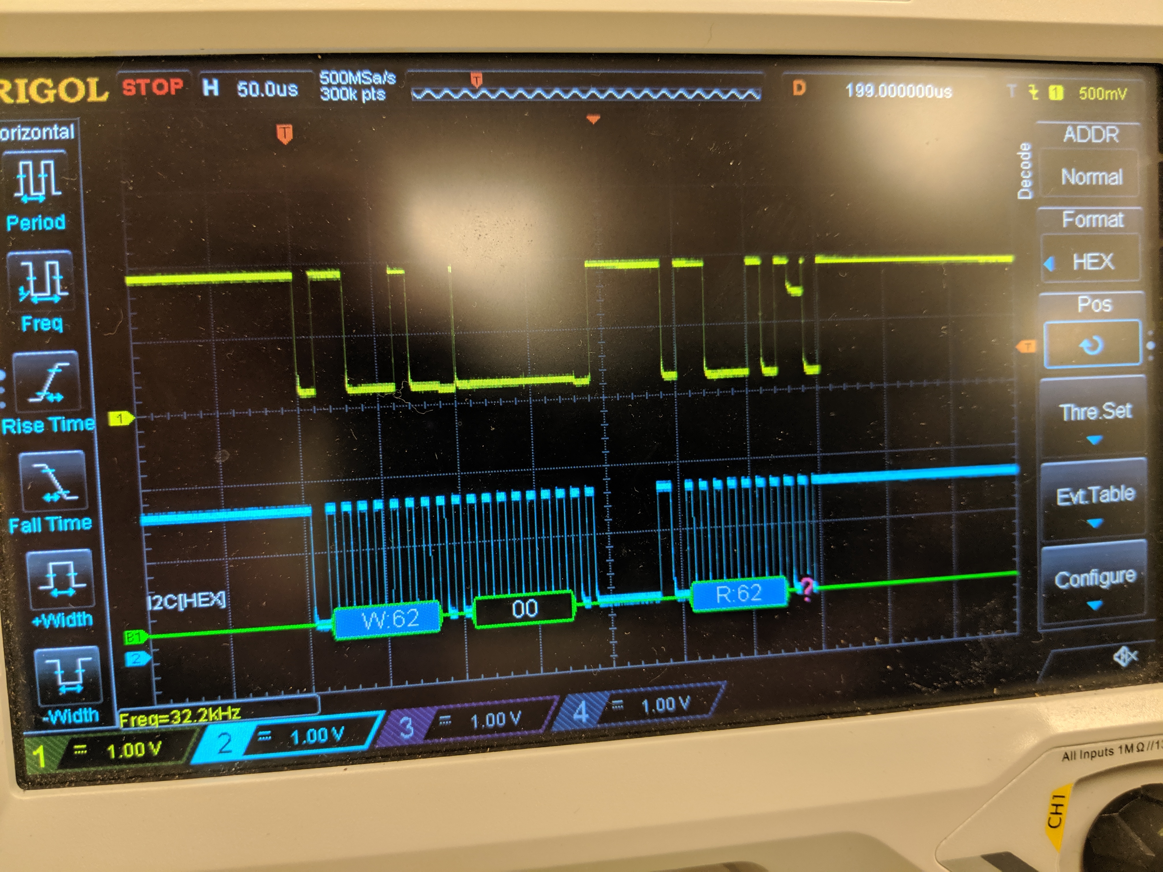

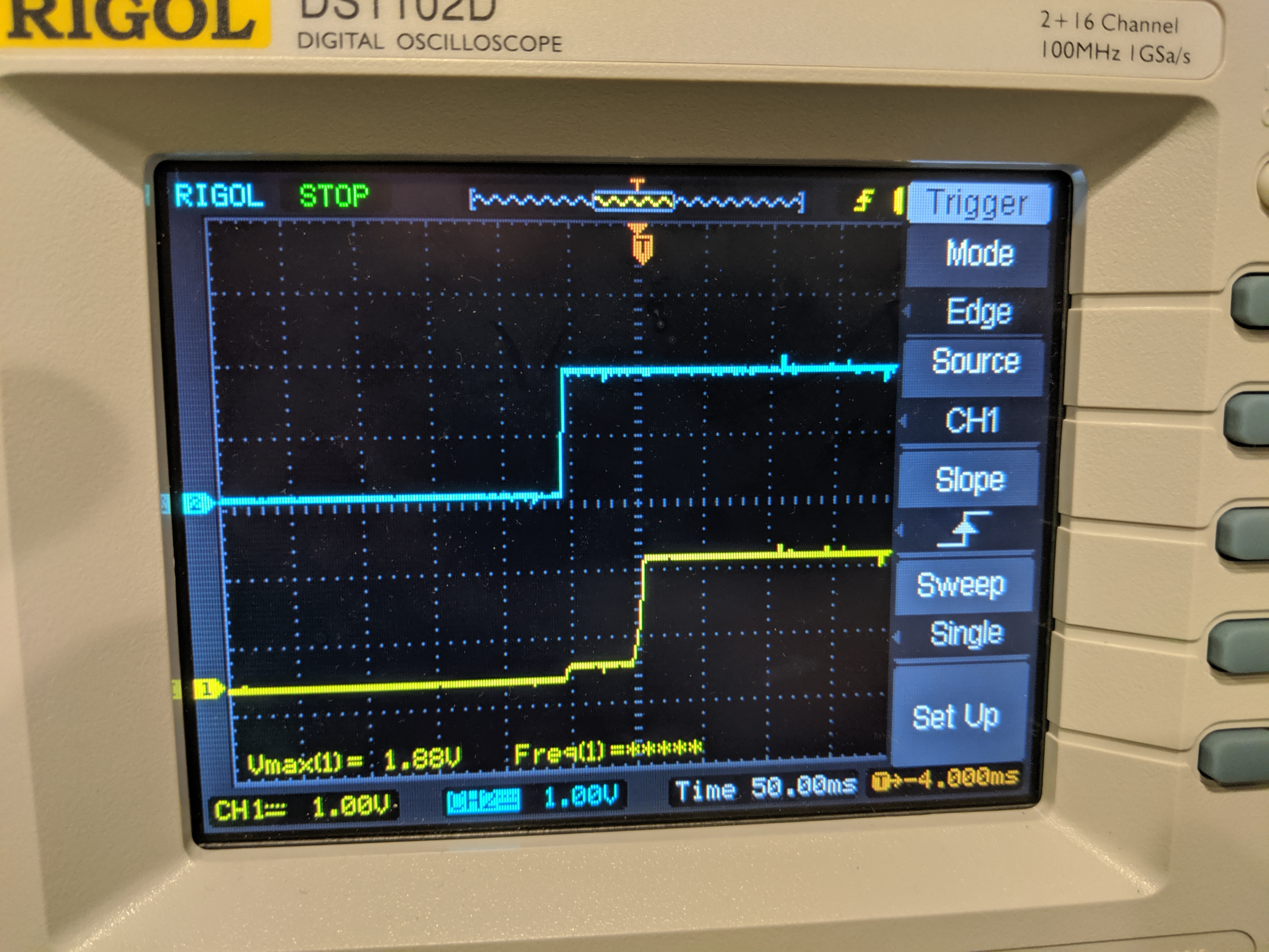

    We did have PDB at 3.3v rather than 1.8v and was driving that into the part.  It is higher than the VDDIO, but still within range.  After fixing that issue, we do not have any of the deserializers showing up in i2cdetect, however they are definitely alive and trying to talk ( just talking over each other )

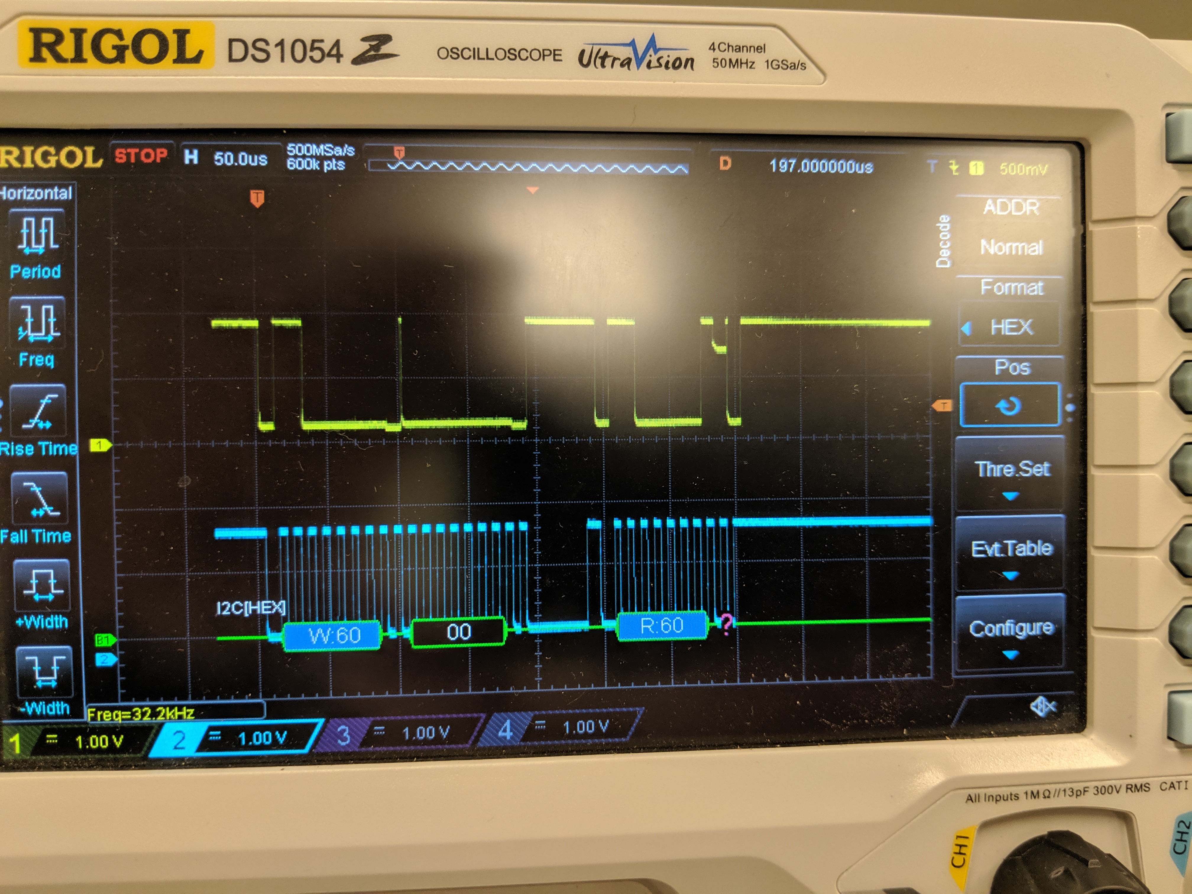

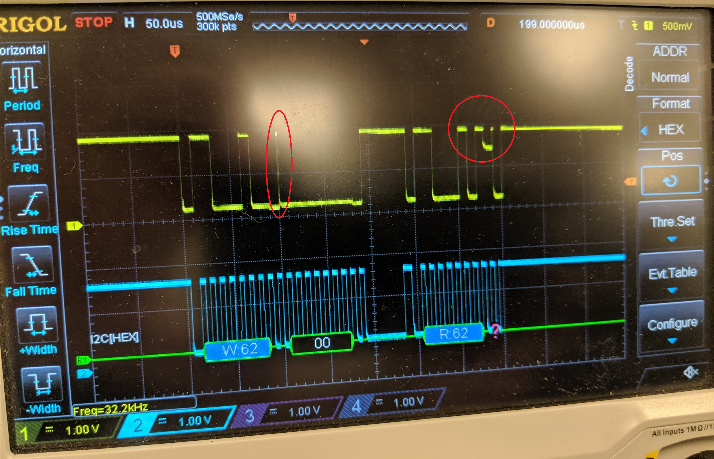

    I took a look at the I2C bus, and saw that there appears to be contention on the bus when trying to read AFTER the initial write.  I've tried the various switches for i2cdetect and i2cget, and none appear to produce any different results.

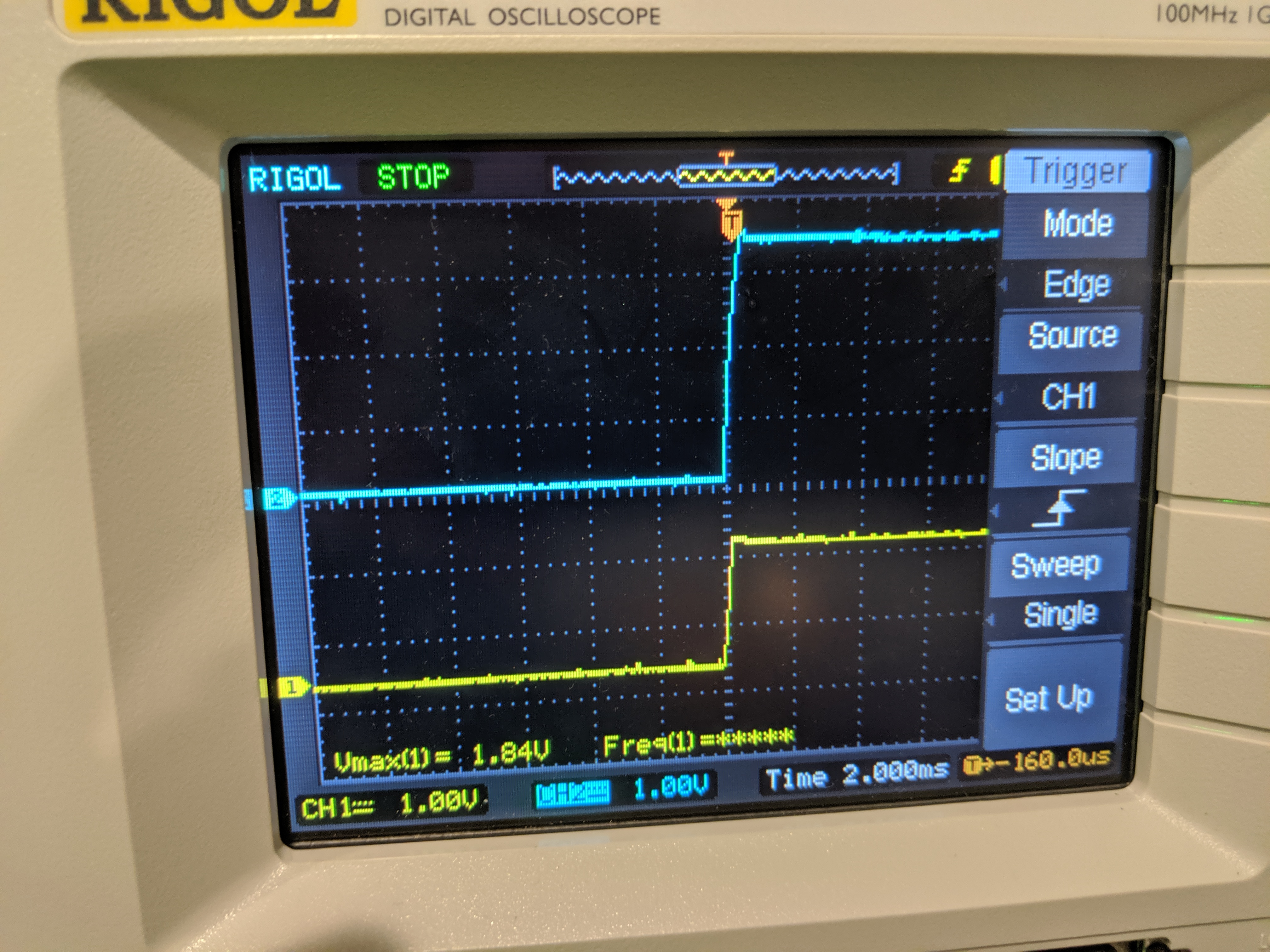

    I have the DS90UB914A evaluation board.  I took a look a the 1.8v VDD rail vs the 3.3v rail for sequencing, and they appear to come up at the same time ( 1.8v in yellow, 3.3v in blue ).
    We have our VDD on one 1.8v rail, and the other inputs on another 1.8v rail.  VDDIO1, VDDIO2, VDDIO3 are on 1.8v_A, which comes up first.  Then, about 50 ms later, VDDD, VDDSSCG, VDDR, VDDCML0, VCCDMC1, and VDDPLL come up.  During this time PDB is pulled low with a 10k resistor to ground.  1.8v_A and 1.8v_B are both fed by 3.3V, but 1.8v_B is sequenced by power good signals from other regulators.

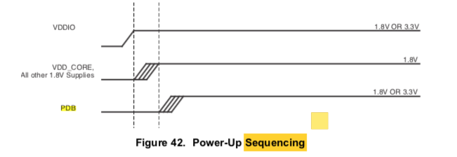

    Per Figure 42 ( http://www.ti.com/lit/ds/symlink/ds90ub913q-q1.pdf ), I would have expected that this sequencing was acceptable:
    The serializer/deserializer pair are working, as I can de-assert PDB ( drive high ) and see that the link Locks, and that I get a valid pclk out.  So it does appear that the deserilizers can't seem to figure out what their i2c address is from the external IDx pins.
    in your case, every package has two IDX0 and IDX1? it has two devices here?
    Also, our UB914a only support 8 diff. IDX addr., if the IDX voltage is not accurate, the IDX addr. would be confused in the I2C bus.

  • HI TD,
    From the SCL/SDA signals measured in your post, it sounds the SDA data is not correct. it sounds it has I2C bus contention here?
    also, can you check the IDX resistor accuracy or can you measure the IDX voltage, is it right?
