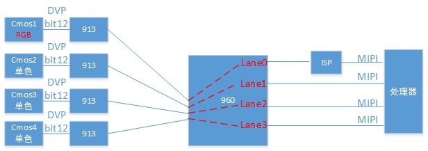

Could i achieve the fuction as below , and each input 913 could be deal with by mcu , many thanks ~

Hello Andrew,
First, you must make sure to use DS90UB913A-Q1 instead of DS90UB913Q-Q1 because the A version is compatible with 960. Also the 960 combines the sensor data from the four cameras into one or two MIPI CSI-2 outputs. The images are separated by virtual channels, not by individual lanes like you are showing in the picture. Please see the 960 datasheet section 7.4.18
Casey
