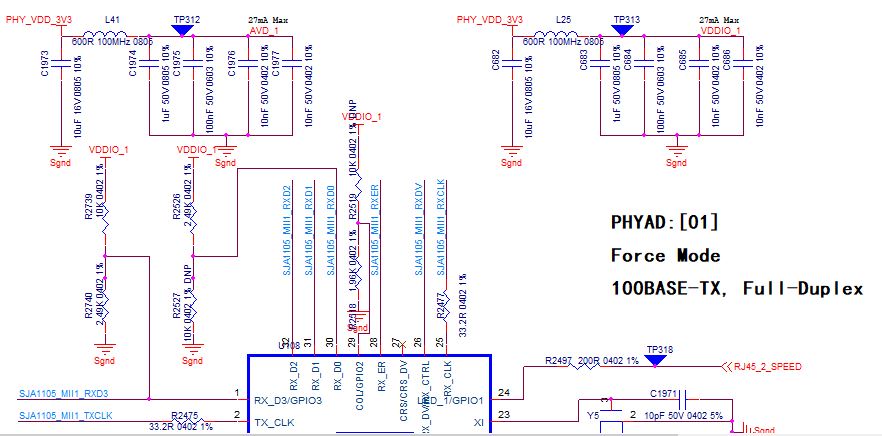

hello e2e team, would you pls go through below schematic to check why it cannot link to PC, the crystal is working nomally.
PIN6/35 is floating, is it ok? what's the function of this two PINs? thank you.

Can you also send the magnetics connection? For the crystal, 10pF capacitors seem too low. What is the load capacitance value mentioned in the crystal datasheet? The general rule of thumb is to use capacitors almost twice the value mentioned in the crystal datasheet. For e.g., if crystal datasheet has load capacitance as 10pF then the circuit should used 18pF capacitors. Can you check in the crystal datasheet and increase the the capacitance if needed?
