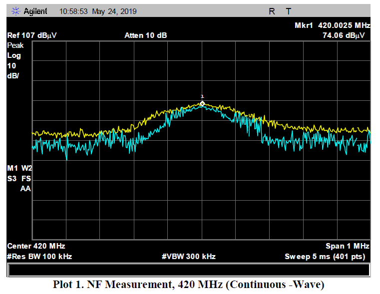

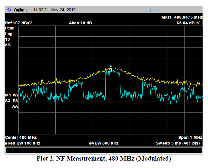

I have very little control over the TUSB1210 USB PHY in terms of EMI/EMC.  I am using a Xilinx ZYNQ device to communicate over ULPI running at 60 MHz.  My customer is testing our board in their setup.  They failed FCC Rule 15.  I am asking the customer to just test Full Speed instead of High Speed to see if the problem areas move around relative to the USB data rate.  Since I have very little control at this device level, I am looking for options that might help reduce the EMI/EMC.  I didn't see any slew rate items in the memory map.  I see in the datasheet in Section 4.1 (Datasheet revised August 2012) that the USB PLL generates both the 60 MHz ULPI and the USB data interface rate (480 Mbps).  I use a 24 MHz clock from the FPGA to feed the TUSB1210.
