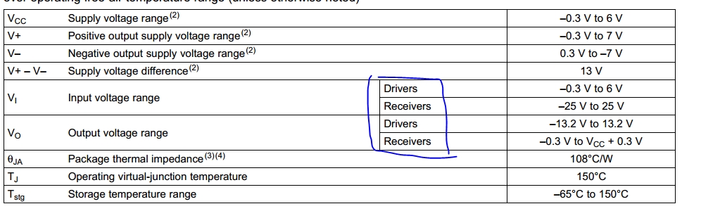

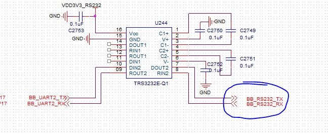

Dear team,
1. If I don't use RIN1, ROUT1, DIN1, and DOUT1 pins. How should I deal with them, float or connect to the GND?
2. regarding the TVS protection of the interface part. The two PIN pins DOUT2 and RIN2, DOUT2 needs to clamp the voltage to13.2V, and RIN2 needs to clamp the voltage to 25V. Is this correct?
Thanks & Best Regards,
