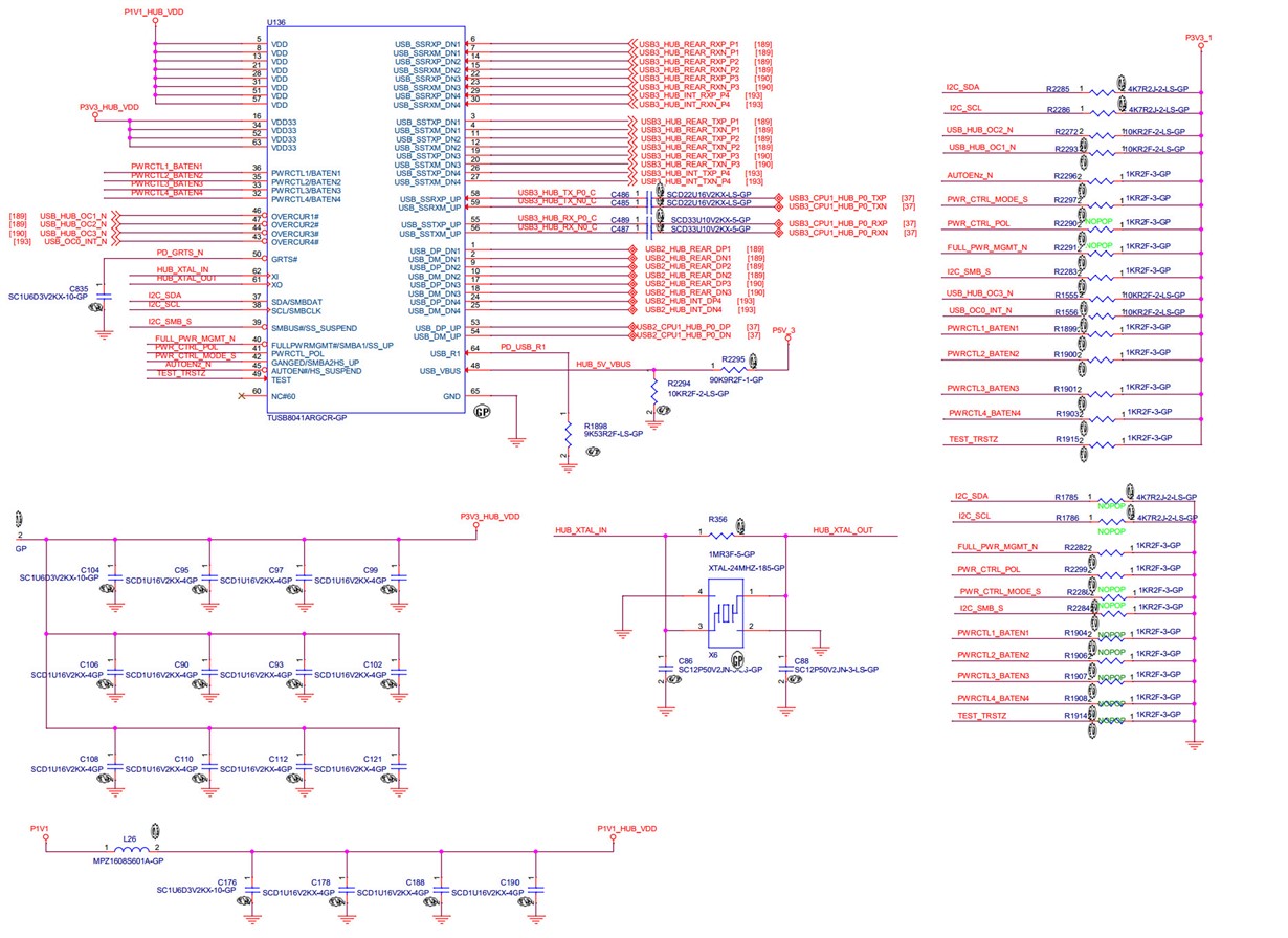

Our board USB port that from USB3.0 HUB, now can’t work if plug USB device during bios post display.
Previous design review schematic as attachment. Would you kindly share debug suggestion for us, thanks.

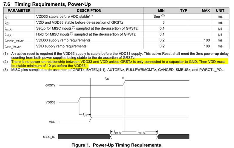

In our design pin 50 connect 1uF cap to GND.
From spec define below, there is no power-on relationship between VDD33 and VDD unless GRSTz is only connected to a capacitor to GND.
Then VDD must be stable minimum of 10 µs before the VDD33.
Could we NOPOP C835 to ignore power timing requirement for VDD and VDD33?
  • Hi Daniel,
    Power up timing requirements can be ignored if an active reset is applied to GRSTz, if only a capacitor is used to generate the reset pulse then 3.3V and 1.1V must ramp simultaneously or 1.1V before 3.3V,
    Please remove R1915 this pullup will put the hub in TEST mode.

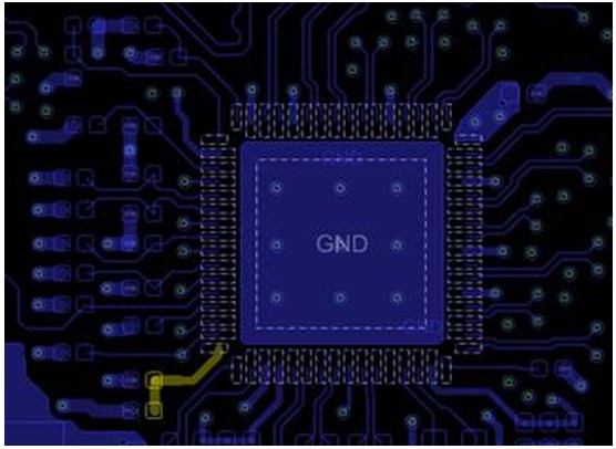

    1)  the TUSB8041A has a solid ground plane connection through the thermal pad
    Daniel: Yes, we have solid ground through the thermal pad as below picture

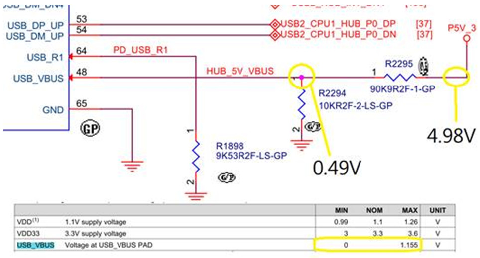

    2) USB_VBUS should only be high when there is an powered upstream host connection
    Daniel: Yes, we confirm the USB_VBUS level is normal

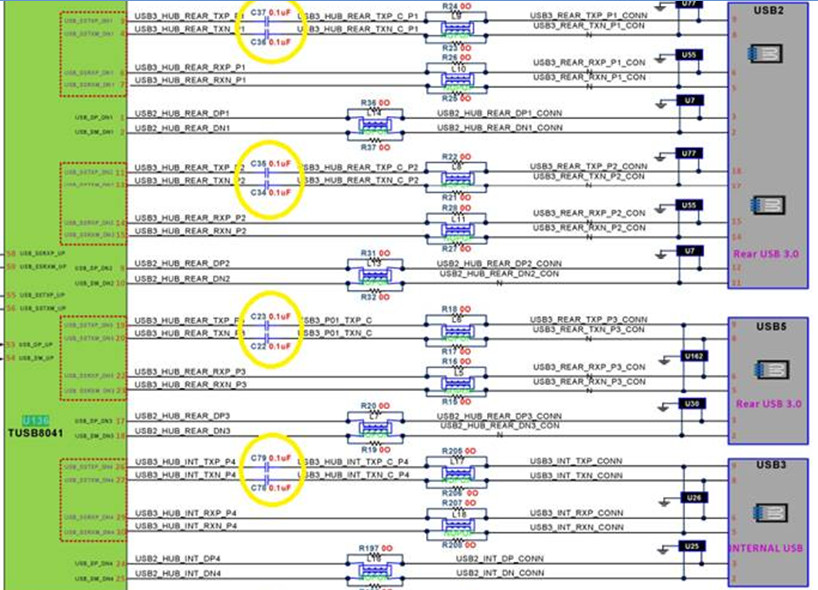

    4) there should be ac coupling caps on the SS TX pairs of each port.
    Daniel: Yes , we have coupling cap in each SS TX pair.

    Are there any concern about our schematic on my first post?
    Like we don't support battery charging, but we pull up all the control pins.

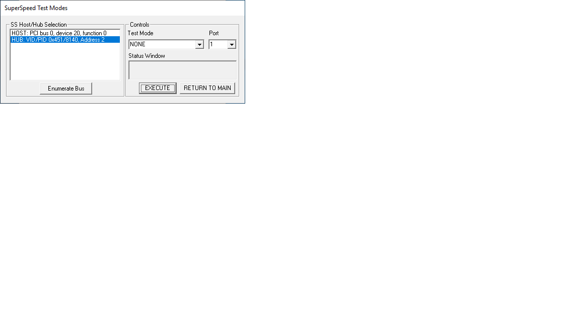

  • Hi Jmmn,

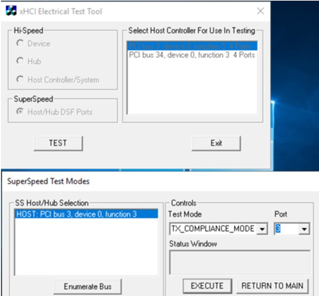

    We have already confirmed the PCI location is “PCI bus 3, device 0, function 3”.(Fig.1) But when we executed this tool, we can’t see the HUB.(Fig2.)
    Fig.1
    Fig. 2
  • Hi Daniel,
    I sent some suggestions over internal email as well, but the hub should show up as connected to the host.  If not, try disconnecting the hub and reconnecting it (or pulling GRSTz low or toggling VBUS) and clicking on the "Enumerate Bus" button.  None of the host ports should be put in compliance mode.  Otherwise you will need to power cycle the system and reload the driver.
