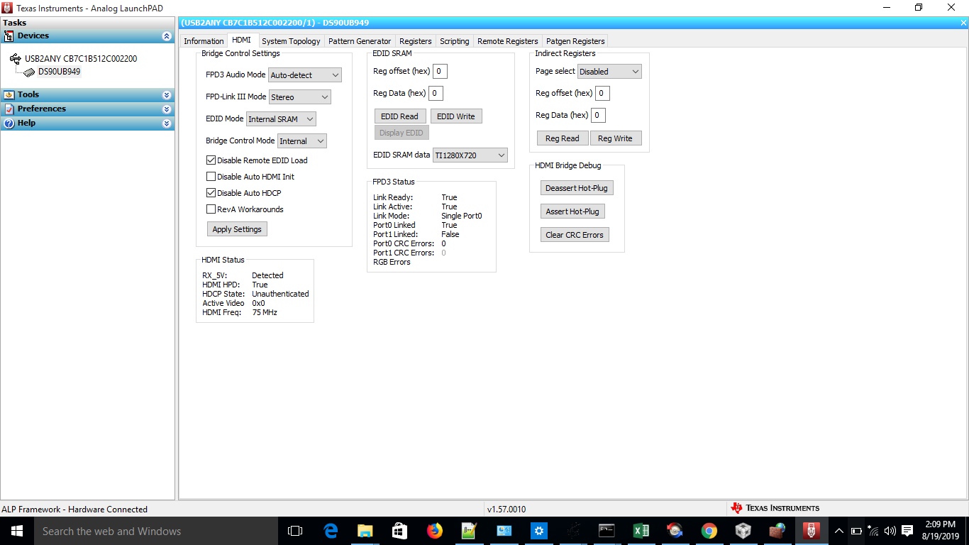

Our LCD resolution is 1280X768. We have initialized the EDID of the Serializer for resolution of 1280X768 and the while connecting the Serializer board to a standard laptop its getting detected as a HDMI display of resolution 1280X768. But HDMI video send out from the laptop is not getting detected by the Serializer.
In the HDMI tab of ALP software, HDMI clock is detected but active video is shown as 0x0 and HDCP unauthenticated. Why is it so?
Is there some registers by which we can check the status of the HDMI video data and the received data's resolution and timing?

    Yes. Our serializer is connected to deserializer remotely. We are able to generate test pattern from serialiser on the display connected to deserializer. we have measured 3.3V as VTERM.
    As per your suggestion, I tested with standard resolution such as 1280x720 p. But still problem exists. Ensured that video source is providing mentioned resolution (1280x720p60). HDMI clock is detected as 75Mhz.

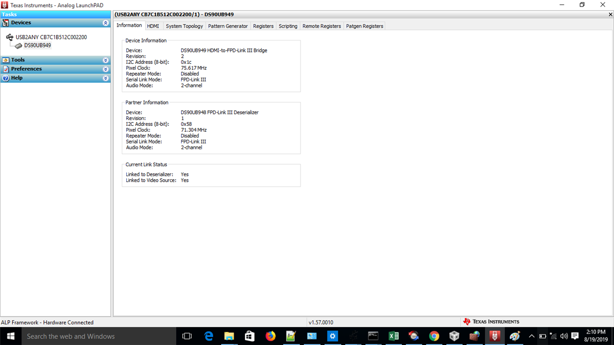

    I here by attaching Information and HDMI tab settings appeared on the ALP tool while giving HDMI input to serializer. One thing noticed is that, Serializer pixel clock is shown as 75.617Mhz where as deserializer pixel clock is shown as 71.304Mhz. Whether this difference in pixel clock is acceptable ?
    Also in HDMI tab, active video is shown as 0x0. Whether we are missing any register settings? Please help. Any hint will be greatly appreciated.

    By the way, the PCLK detect circuity in both sides is not meant to be highly accurate. It is normal to see a difference between source and sink reports.

    We are using direct connection from standard laptop HDMI port to serializer input. Display setting shows resolution of 1280x720p as per our EDID settings.
    For the pattern generation, there are pattern generation registers to configure the LCD screen resolution but while giving the actual HDMI data we didn't see any registers apart from the EDID setting to specify the screen resolution. Our understanding is that we need to configure screen resolution only in the EDID while processing actual HDMI video, is this understanding correct?
