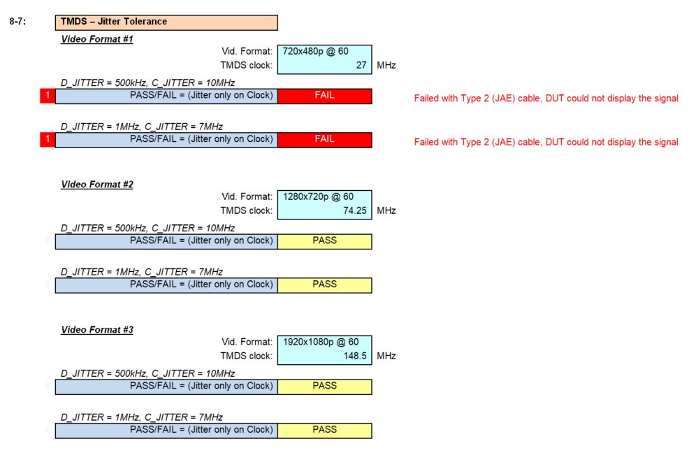

I have a customer using the TMDS361BPAGR to bring in 3 HDMI signals to a single HDMI receiver chip Analog Devices ADV7611.  When he sent his product through HDMI compliance he had one failure when they ran the HDMI Sink Jitter test 8-7 at 27Mhz (480P resolution).  The console passed testing at higher resolutions of 720P and 1080P.  This was done using a “TYPE 2 Cable Emulator” that adds skew into the signal. Although he suspects the issue is at the ADV7611 side of the design, there is potential the TI part is contributing to the failure.  He has had several calls with the compliance lab and Analog Devices on this and there were some questions that came up on the TI part.  Could you please take a look at these questions below?

  • I believe that this might be what you are looking for.  Do we have an eval board they can test with?
    8-7:
    TMDS – Jitter Tolerance
    Video Format #1
    Vid. Format:
    720x480p @ 60
           TMDS clock:
    27
    MHz
    D_JITTER = 500kHz, C_JITTER = 10MHz
    1
    PASS/FAIL = (Jitter only on Clock)
    FAIL
    Failed with Type 2 (JAE) cable, DUT could not display the signal
    D_JITTER = 1MHz, C_JITTER = 7MHz
    1
    FAIL
    Video Format #2
    Vid. Format:
    1280x720p @ 60
           TMDS clock:
    74.25
    MHz
    0
    PASS
    0
    PASS
    Video Format #3
    Vid. Format:
    1920x1080p @ 60
           TMDS clock:
    148.5
    MHz
    0
    PASS
    0
    PASS

  • The console was retested on 8/30/19.  It still has a failure at 480P.  The lab comment on this is:
    • Retested Input1 with JAE 27M CE and repeated video failure (unstable/flickering test pattern on display) at 0.6 Tbit Skew of Clock10MHz-Data0.5MHz Jitter Profile
    When I look at section 8-6 of the HDMI 1.4a testing spec, it appears to show that a 0.4Tbit skew would still be acceptable.  I only see the lab tested at 0.6Tbit of skew, so I have sent in a question about the 0.4Tbit.
  • Steve

  • David,
    The problem only shows up while jitter is applied for a 480P resolution.  There are no issues when jitter is not applied.  There are also no issues if at 720p or 1080p with or without jitter applied.
  • Steve
    If the problem only shows up when jitter is applied, then I don't believe this is a equalizer issue.
    The TMDS361B will not clean up the jitter, so we need to take a look at the  ADV7611, to see if it has a CDR or PLL and change the bandwidth to better track and filter out the jitter.
