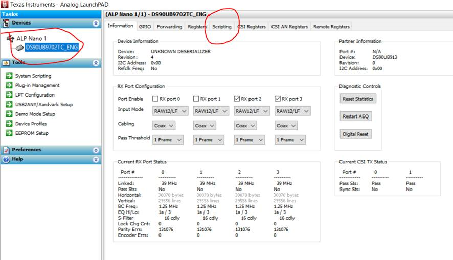

  • Paul,
    Are you using “System Scripting” under Tools? System scripting doesn’t know any idea of the profile and so board object will be unknow..
    Please select the profile and use the “Scripting” tab.
    See example picture below
    Vishy

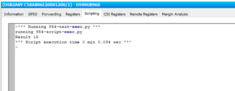

  • Paul,

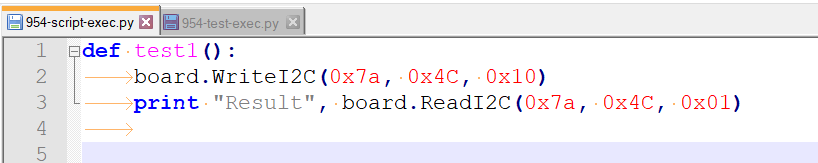

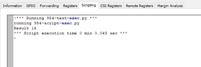

    I tested a small example like yours:
    a) "954-test-exec.py"
    b) "954-script-exec.py" with the print "Result" like yours
    When I run this under ALP, I see "Result" printed out as below
    Vishy

  • I realized you have the test1() function defined on the print result file as below
    I do see the result printed even when defined as a function (without additional function call).
    Vishy

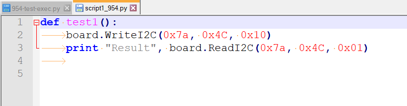

  • Paul,
    In the example below, I have used import instead of execfile and show how the function test1() in "script1_954" is called to print the result.
    Vishy

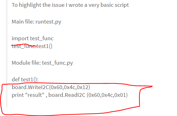

  • Paul,
    You need two changes to your basic script
    a) no need to specify module name.
    b) the two statements should have a tab before them
    By the way there are a number of example scripts under the following ALP install folder
    C:\Program Files (x86)\Texas Instruments\Analog LaunchPAD v1.57.0010\PreDefScripts\DS90UB954

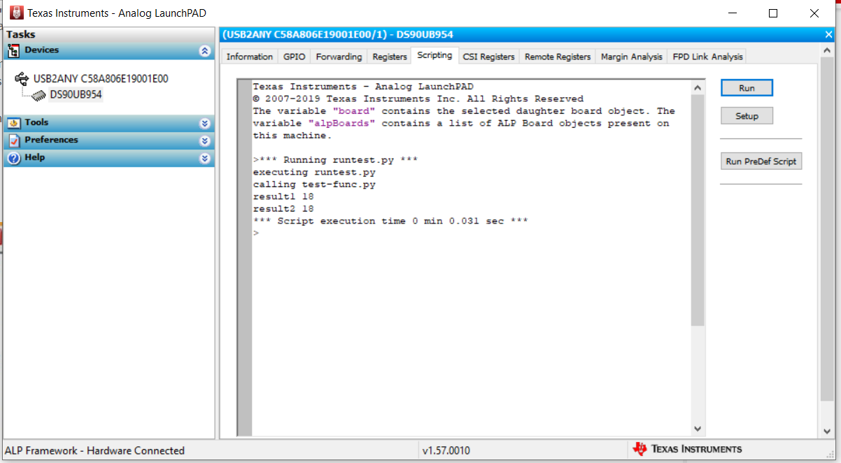

    I have included a picture below which shows the two files, the results when running the main script file (runtest) and the results when running the module commands separately on the command line.
    Is there a setting within ALP or a modification to the scripts which will allow my script to run successfully?
    Paul

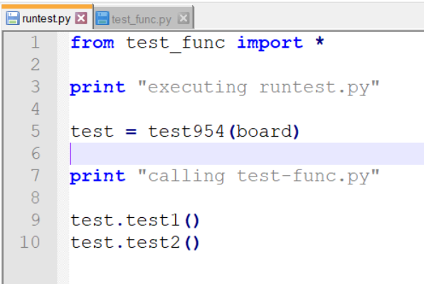

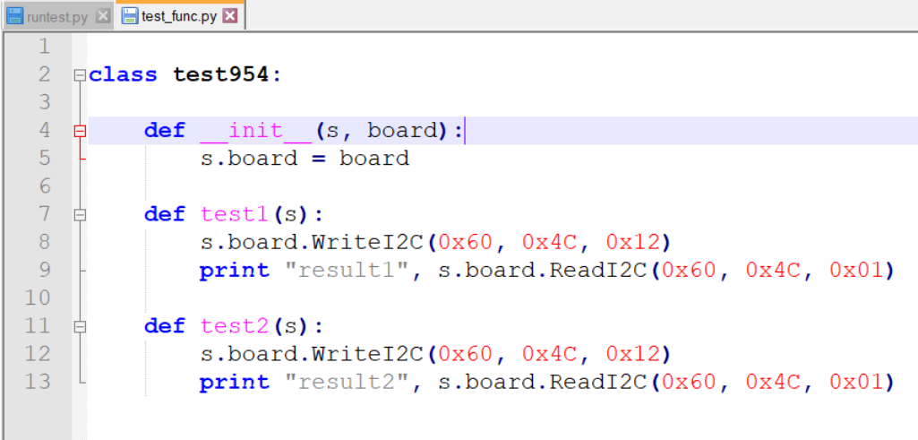

  • Paul,
    I modified your examples "runtest.py" and "testfunc.py" and was able to get it to work. Basically, I had to create a class and pass the "board" global to it. See screen shots below.
    Sometimes I found you have to quit and restart ALP for it to recognize changes inside class definition (on the second file). The ALP shell somehow doesn't recognize the changes and restarting only helps.
    Vishy
