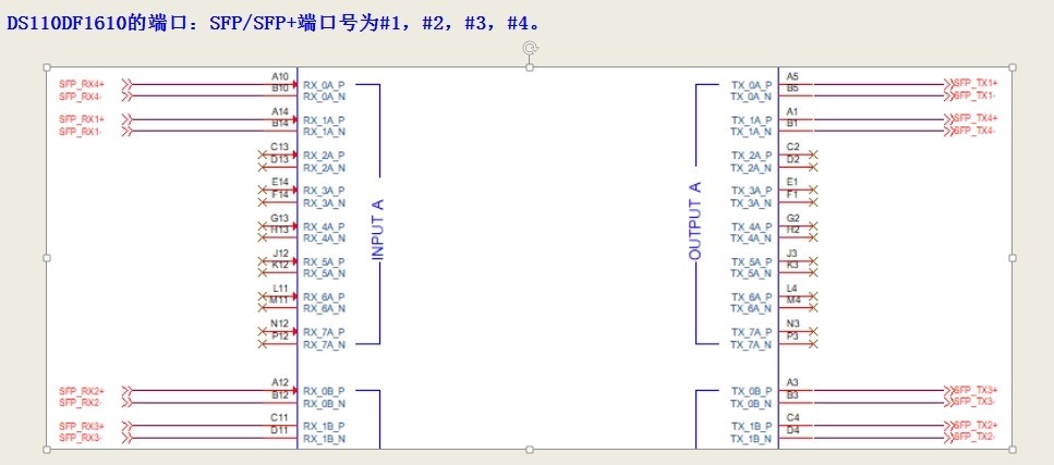

Hi expert:

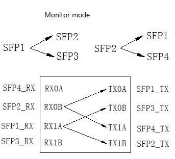

My customer use DS110DF1610 for conversion card. The schematic diagram of our product is as follows:
Because some cards can be locked, but some cards can not be locked. Later the cards were modified to not use cross point and not to use the manually set rate, the result is the same as before.
Attached is the chip initialization program, the debugging information of cards that cannot be locked and  debugging information of the cards that can be locked .
