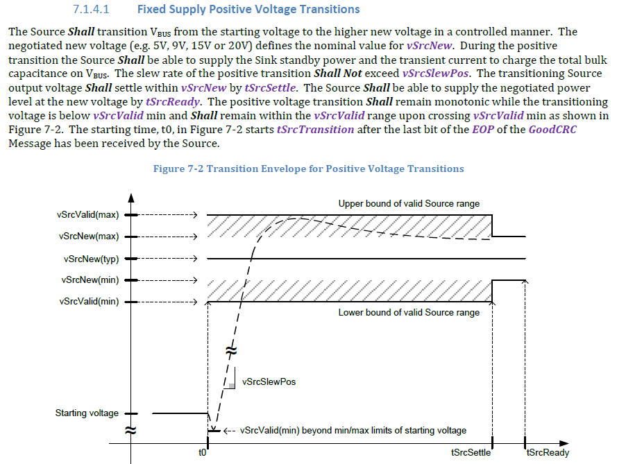

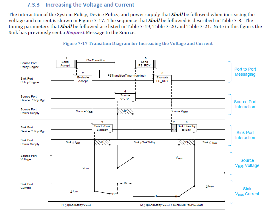

Hi~
As you know the PD adapter’s voltage was variable , when the PD adapter plugged, the PD adapter voltage will change from 5V to 20V. May I know
1. Will PD controller active UVP or/and OVP during transition?
2. When is the judged point when PD controller start to gate UVP or/and UVP?
Thanks and BR,
