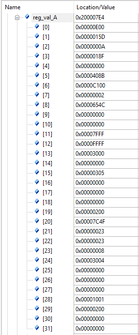

reg config as pic.
one used 8/10B one not use.
TX fifo overflow even loopback.
Pls kindly help.

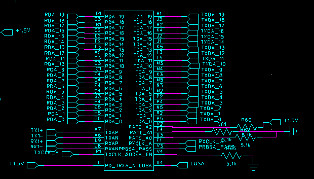

        • The schematic diagram of hardware is shown in the figure(A  channel)
          clk_out_sel = 1'b0
           refclk_0_p = 122.88M
           refclk_0_n = 1'b0
           refclk_1_p = 1'b0
           refclk_1_n = 1'b0
           TXCLK_A = 122.88M
           refclk_a_sel = 0
           refclk_b_sel = 0
           prbs_en = 0
          Send data as follows:
                                      TXDA[7:0] = tx_data[7:0]
                                      TXDA[17:10] = tx_data[15:8]
                                      TXDA[8]   = tx_k[0]
                                      TXDA[18] = tx_k[1]
                                      TXDA[9]   = 0
                                      TXDA[19] = 0
          The tx_data  is based on 16-bit data of the TXCLK_A  clock.
          tx_k[0]  contains the control bit (k-character indication) of data byte TXDA_[7:0]
          tx_k[1] contains the control bit (k-character indication) of data byte TDA_[17:10]
    • LINE RATE = 2457.6M
      SERDES PLL MULTIPLIER VALUE  = 20
      RATE SELECT = 0.5 (half)
      TXCLK_A/B = 122.88M
      REFCLKP/N = 122.88M
    • The register configuration for A channel is shown below
  • Thanks for your setup details. I'm not immediately identifying an issue with your setup. Could you double check and confirm the following for your setup?
    • Unused parallel input pins are grounded
    • Double check pin configuration and settings versus datasheet section 4.18.2 "16-Bit Interface Mode (8b/10b Encoder/Decoder Enabled) (All CPRI/OBSAI Rates)". In particular, confirm the following for your setup,
      • Device Pin Setting(s)
        – Ensure CODEA_EN input pin is Low.
        – Ensure CODEB_EN input pin is Low.
        – Ensure RATE_A[2:0] input pins are 3’b100 (High, Low, Low) to enable software control.
        – Ensure RATE_B[2:0] input pins are 3’b100 (High, Low, Low) to enable software control.
        – Ensure PD_TRXA_N input pin is High.
        – Ensure PD_TRXB_N input pin is High.
        – Ensure PRBS_EN input pin is Low.
        – Ensure REFCLK_A_SEL input pin is Low to enable software control.
        – Ensure REFCLK_B_SEL input pin is Low to enable software control.
