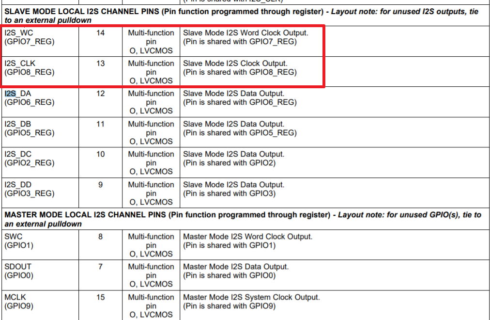

  • Dear Vijay,
    Ok, got it! But the clock is also output when setting slave mode, you can refer below picture,

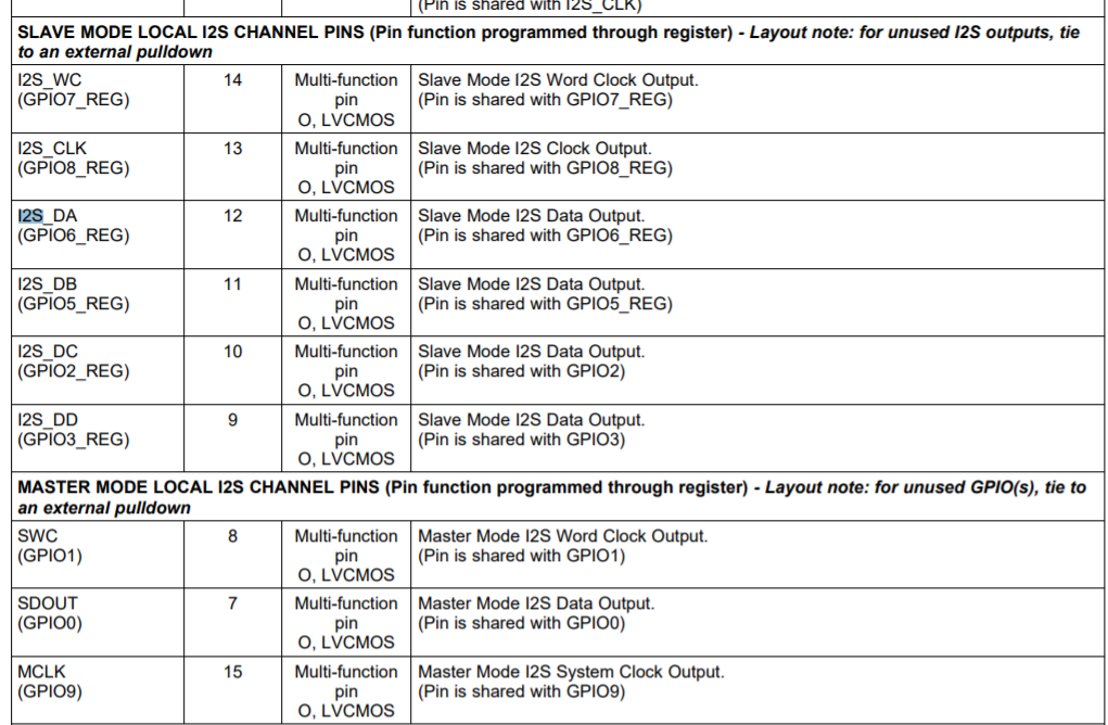

  • Hello Sherry
           Sorry for not being very clear. Thank you very much for pointing out something in our Datasheet that could be mis-leading and needs more explanation.

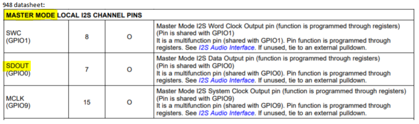

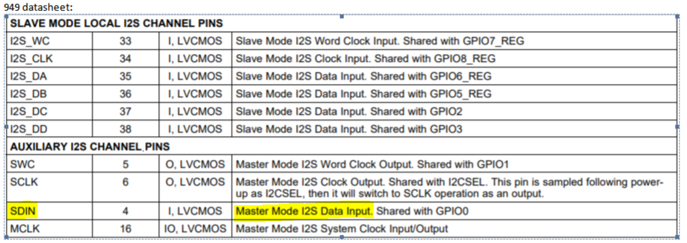

    What we refer to slave mode is applicable for 8-channel audio. In this case Audio source is on the Serializer side and uses I2S_DA/DB/DC/ etc pins to drive Audio into the serializer which show up on the Deserializer I2S_DA/DB/DC..etc outputs.
    What we refer to as Master mode is ONLY relevant when 948 or 940 is paired with 949 Serializer and Audio is send through AUX input of 949.,SDIN as Audio Input. Shown below:
    So slave terminology represents standard 8-channel audio and master terminology refers to use of AUX channel Audio. Once again than you very much for pointing out that the description is not very clear. We will include a more explicit explanation of this in our next datasheet release
