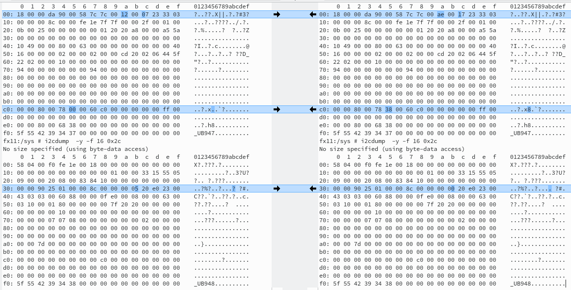

We had a figured screen (thin vertical bar) problem  while system power-on at room temperature.  (  SOC-DS90UB947-----DS90UB948-LCD)
Disconnected  the lines between 947 and 948, the system reinitialize 947 and 948. Screen display normal.
We read the registers of 947 and 948. There are some differences between screen figured and normal status , as follows, please help to analyze.
1. These registers are not configured in our system. They are read-only or unpublished registers. What will lead to the values changes of registers?
2. From the function of registers, it can be ascertained that the problem of figured screen is caused by the change of parameters.
3. Please provide the functions of reserving registers.
947 inconsistent registers: 0x0a, 0x0c, 0xc5
948 inconsistent registers: 0x3b
0x0a: 0x12 vs 0xAE - CRC Errors, ReadOnly
0x0c: 0x07 vs 0x17 -- Gernal Status, ReadOnly, High 4 bits Reserved
0xc5:0x00 vs 0x38 -- Undisclosed Registers
0x3b: 0x05 vs 0x00 -- Undisclosed Registers
  • Hi, pls check below comments on your questions.
    -> 0x0a/0x0c is on link error. Due to instable system during the power-on, sometimes the link would report the error. so it is normal that your link after power-on has error. you can read and clear these error and read again, if it still has error, it means your link has bit error. you need improve the high speed serial link design robust to remove the link error.  (0x0c)
    Link Lost Flag for selected port:
    This bit indicates that loss of link has been detected. This register bit will stay high until cleared using the CRC ERROR RESET in register 0x04.
    0x3b is receiver equalizer status, which also is dependent on the link stability. if the link loss is large, this EQ value would be high.
    -> not, it can't. as mentioned, these register is on the status after power-on, and it would be changed in some extends. For your issue, what is the "thin vertical bar"? sorry we can't understand it.
    -> 0xc5 is on HDCP, it is not used in your UB device. 0x3b is on EQ status in receiver side,
    Steven

  • Hi cary,
    1. the reg. 0x04, 0x0a, 0x0b just indicates if the link has bit error not, it can't resolve the bit error.
    2. as mentioned, please check whether the link has bit error after you clear the error record in reg. 0x04, 0x0a, 0x0b? if it still have bit error, please check the serial link jitter margin design. any unlock in ub948 side?
    3. what is the "flower screen"? and how about the failure rate? what is the PCLK freq.? is it dual OpenLDI input in UB947 side?
    best regards,
    Steven

    for your issue, please make sure that the error is clean after power-on. if the link still has issue, please past the picture/video to better understand the possible reasons. also, you can check:
    1. when issue is reported, running the pattern test with internal and external, in ub947 and ub948 side respectively, are they all ok?
    2. when issue is reported power down and power on 948, does it recover?
    3.when issue is reported power down and power on 947, does it recover?
    4. power off and power on the total panel is it recovered?
    we can identify the possible reasons in your link better.
    regards,
    Steven
