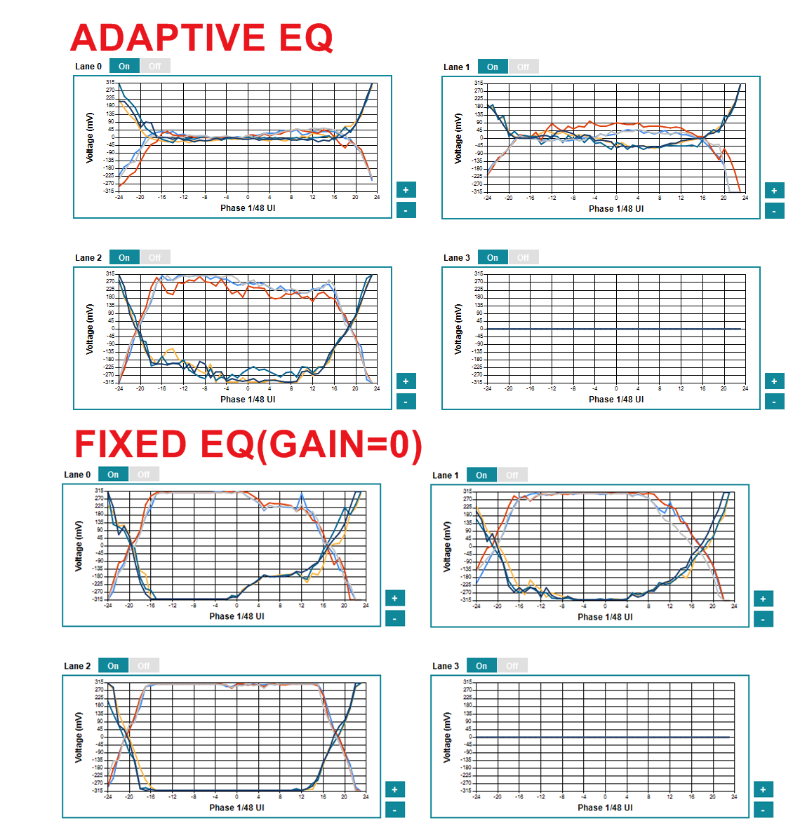

In some cases we are facing an issue with the adaptive equalization that seems to not behave as expected.
Looking with the LinkEye Tool at the equalization gains imposed by the adaptive equalizer we have found that on 1 or 2 lane we have the gains at the maximum levels even if we are using a very short cable(1m). If we manually set the equalization gain to a lower level we have a clean video signal.
In our application we have to support both short cables and longer cables(max 20m), so the adaptive equalizer is a feature we would like to have enabled and working.
What can cause the adaptive algorithm to work in a wrong way and set the gain at the maximum?

  • Hi
    here I have the register dump in the case of a short cable(1m).
    As i said the adaptive equalizer set the gain at an high levels and the equalizer gain is changing continuously

    lane 0  min=11.5dB  max=14.62dB
    lane1   min=8.8dB   max=14.62dB
    lane 2  min=3.8dB   max=8.8dB
    Why is it doing so? The best eye with eyescan is at an equalizer gain of 0dB. Why it is not finding the best gain?

  • Hi
    if I change the cable from short to long and viceversa the adaptive equalizer change the equalizer gain even if in our board we have the HPD_SNK fixed with a pull-up.
    In case of long cable the adaptive equalizer find a equalizer gain set that is near to the optimal.
    In case of short cable the adaptive equalizer find a equalizer gain set that is far from the optimal as you can see in the following image:
    What can cause the adaptive equalizer to work in this wrong way?
    If I toggle the HPD_SNK manually nothing change.
    If I scan the eye with all the different fixed gain value it is confirmed that the best setting is the one with fixed gain set to 0 and the adaptive equalizer set the gain to 11, that seems to me a wrong behavior, as you can see in the following image:
    Can you please help us in understanding why this happen?

  • Stefano
    1. If I change the cable from short to long and vice versa the adaptive equalizer change the equalizer gain even if in our board we have the HPD_SNK fixed with a pull-up.
    2. In case of long cable the adaptive equalizer find a equalizer gain set that is near to the optimal.
    3. In case of short cable the adaptive equalizer find a equalizer gain set that is far from the optimal.
    Are you saying that for short cable, even though the equalizer is changing, the equalizer is changing to a less optimized position?

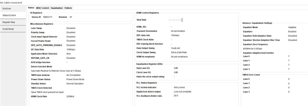

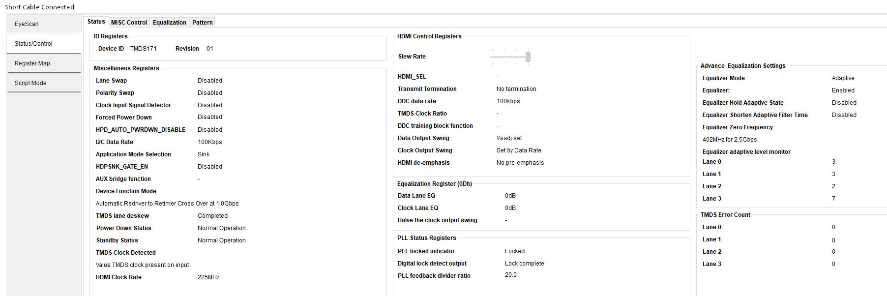

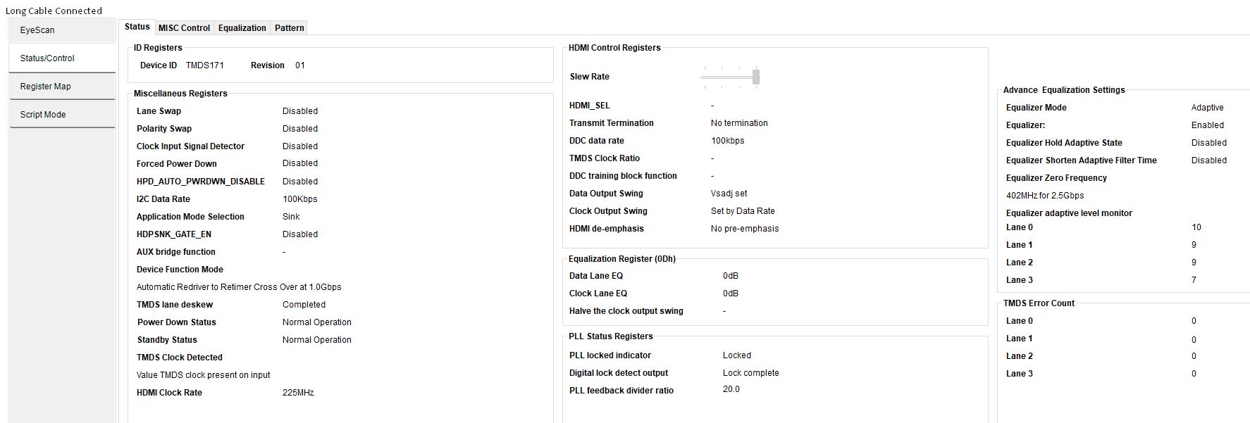

  • Stefano
    Please give me few days to set up and duplicate the issue on the TMDS171 EVM, and I will reply to you what I find.
    David
  • Stefano
    Here are the results from my testing on the TMDS171 EVM. I am seeing the equalizer adapts correctly to both the long and short cable.
    Have you seen this issue on multiple boards and with multiple cables?
    No Cable Connected
    Long Cable Connected
    Short Cable Connected
