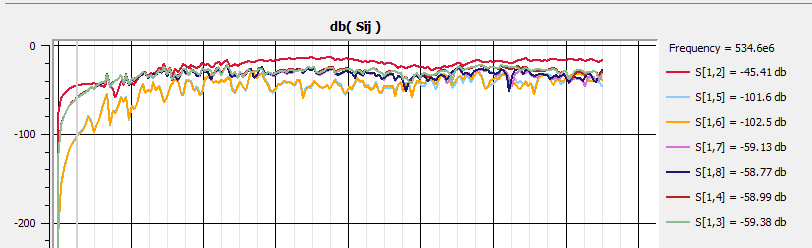

I put the TI model and PCB SNP file in .zip for you to download

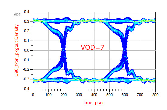

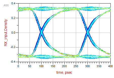

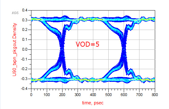

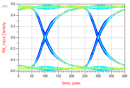

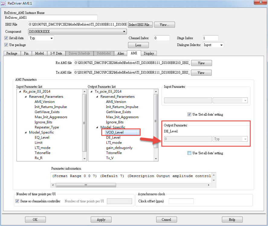

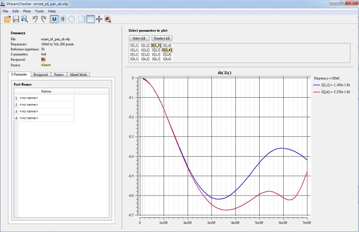

Currently testing the output of TI's Redriver model... after entering PCB2 (1.2 inch)

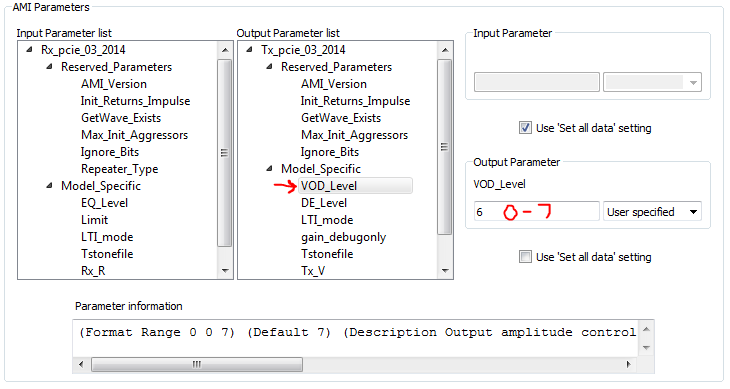

Voltage attenuation is very serious... adjusting EQ/DE does not improve output
We use the ADS Tool to do the simulation:
Please help me confirm the adjustability of this model.
