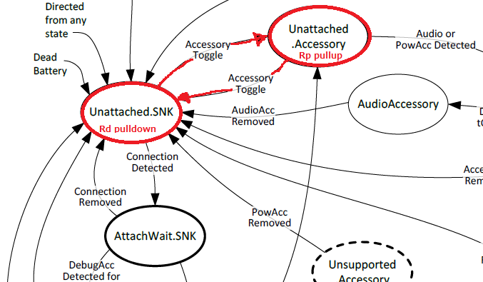

Hi team,
Could you answer the following questions?
1. The device is UFP mode and "UFP accessory support" is enabled(Address 0x09, 0bit = "0").
     If the UFP device is attached in this condition, what is the attached state, "Not attached" or "Attached SNK"?
2. Is it able to set "disable" to DISABLE_UFP_ACCESSORY register in the state other than "Not attached"?
3. Is it able to set "disable" to DISABLE_TERM register in the state other than "Not attached"?
    If yes, does the attached state become "Not attached" when DISABLE_TERM is set to "disable"?
    Also, does the attached state become "Not attached" when ENn_CC is set to HIGH?
