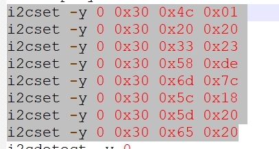

The project needs s32v234sbc to connect to the 936 adapter board via mipi, and then connect to the lvds harness driver camera. We designed our own adapter board according to the common circuit of 936 (the circuit diagram is attached), but it can't adjust the 936-935. The line, can not see the 935 and the camera address, the camera manufacturer has been tested, has successfully matched 954-935 also recommended us to use the 954 chip, but the 954 chip can not meet the needs of two cameras because of a single channel, we only use 936 , (the circuit diagram provided by the camera manufacturer is attached as an attachment)
Asked to help review the circuit board for problems?
Request a register configuration to help design the connection?
(The configuration commands we use now are as follows)

    No matter how I configure it, what I see on register 0x5B is 0x00 only。Can you recommend an i2c setting for the 936 paired with the 935?For example, set register 0x58 to 0x58...。
    thank you
    jiaxin

    Hello, I changed the mode of the pin resistor configuration for mode4, then I tried a lot of kinds of software configuration register, but still cannot see 935 address, in 936 registers 0 x5b is always 0 x00 never change, also only 936 on the i2c bus address, could you please recommend a pair of 935 936 software configuration register?In addition, please analyze the reasons for this phenomenon.
    thank you!
    jiaxin
