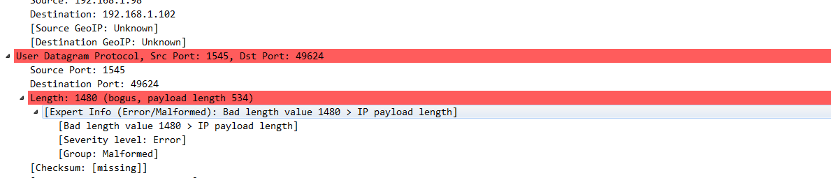

  • HI,
    now,i  still have 2 problem:
    1.the host can transmitte  data packets   correctly. afer pass the PHY,the short packets transmission (200 bytes)  is no problem,but when transmitting long packets(1400bytes),issues occur.  for example ,1400bytes,the front packet bytes is correct  ,but  the last packet bytes  loss all .
    by the way,normal  64 bytes ping,it's no problem. when ping 1400 bytes,data loss very Seriously.
    2.In normal operation mode ,soft-reset can work correctly.  When MII loopback , after soft-reset ,the PHY can not link normally. additionally,the same cords and the same configuration can work normally on Xilinx DEMO  board.
    please help me analyse the cause,thanks very much!
