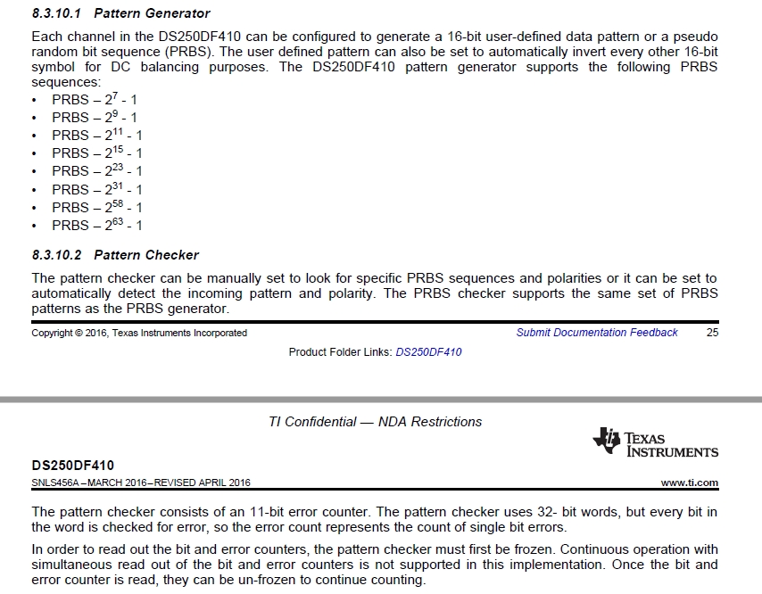

1. What is the rate range supported by DS250DF410 to send PRBS and PRBS check?
2. Do these two functions require additional clock input?

  • According to the reply,
    the condition for the DS250DF410 generate PRBS Pattern, is that there is a reference clock at the high speed input?
    What about the Pattern Checker,also need a reference clock input at the high speed?

  • What about the Pattern Checker,also need a reference clock input at the high speed?
    Could you please answer this question? Thank you!
  • The TI retimer Rx channel simply needs input PRBS data to be able to perform its PRBS checker function. Note that the TI retimer uses a simple 25MHz input calibration clock.
