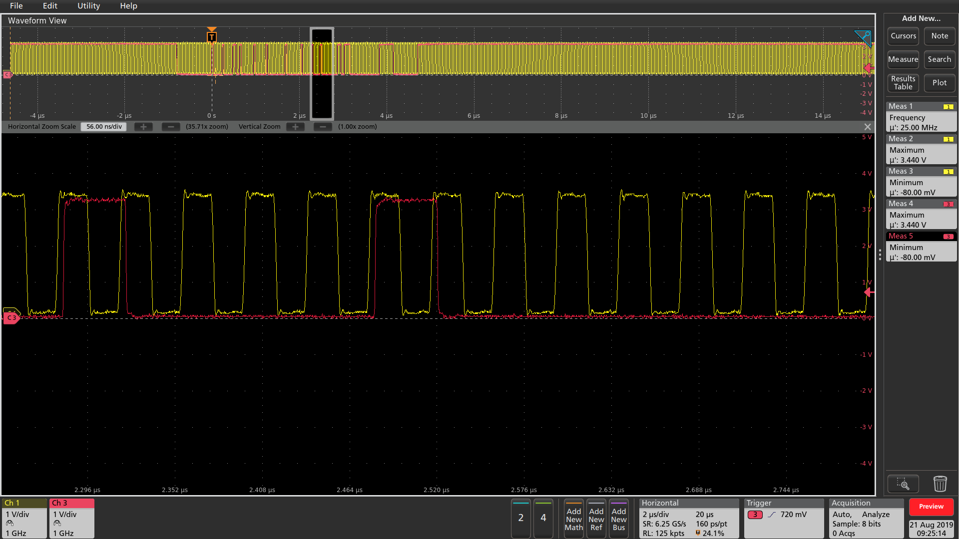

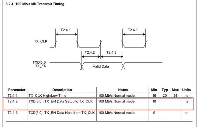

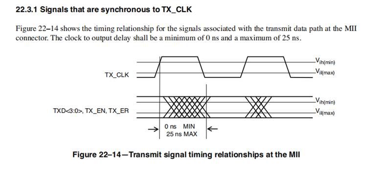

When we recently tested the timing specifications of the MII interface, we found that the MII Transmit Timing of the DP83848N has an index requirement that the TXD setup time is greater than 10 ns. However, the IEEE Std 802.3-2005 standard only defines the TX characteristics of the MAC, and requires the TXD output delay to be 0-25 ns. The CPU (MAC) we use also conforms to this standard. However, the 10 ns requirement of the DP83848N cannot be met when the waveform setup time indicator is tested on the DP83848 N terminal.

1. Does the 10 ns minimum requirement of the DP83848N specification deviate from the standard?
2. How should we test the DP83848N setup time indicator?
    DP83848 PHY MII Interface needs stabilized data  when the Clock is transitioning. With 0 ns min, both data and clock  will transition together.
    Min of 10 ns is MII TX_CLK to TX_D0 spec for all TI PHYs.

    According to the standard, in the MII mode, TX_CLK is sent by the PHY to the MAC, and the TXD of the MAC is delayed by Tov (0ns-25ns). For example, if the MAC outputs TXD after 2 ns, then the 10 ns requirement of the PHY cannot be met.
