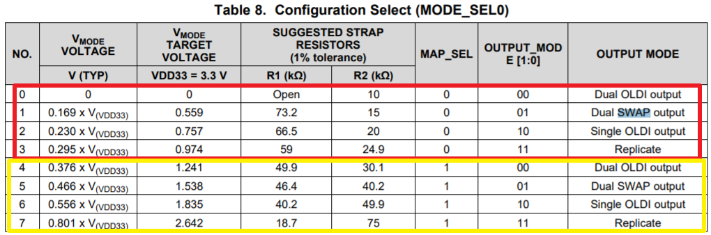

Dear team,
Could you please tell me what does the SWAP mean? In addition, is there any difference when the MAP_SEL=0 or 1?
Thanks & Best Regards,
Sherry
