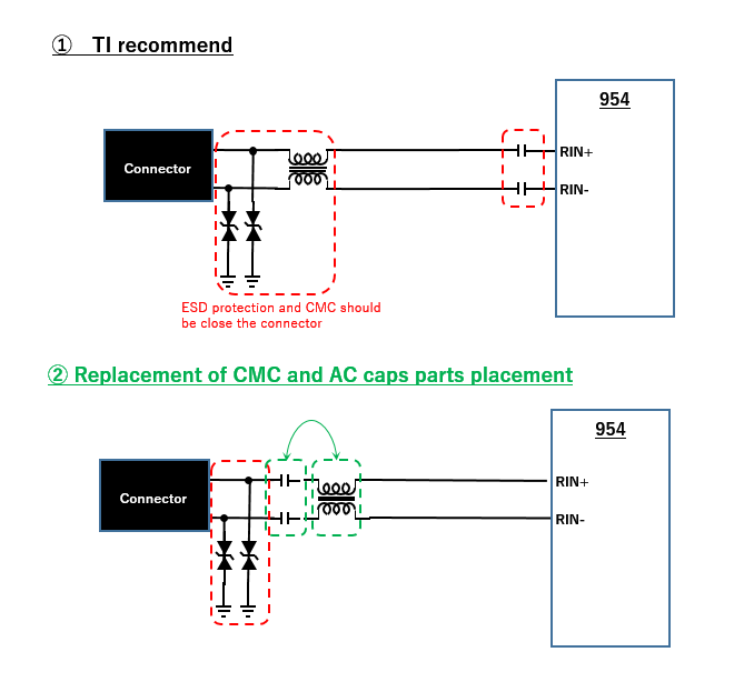

I have a question for placement of CMC and AC caps.
I understand that TI recommend CMC is close connector and AC caps are close 954.
Is it okay to swap CMC and AC caps, that is, to place the CMC near the IC and AC caps near the connector?
