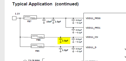

#2
According to the pin function, 10uF and 0.01uF are required for the VDD11_CSI pin.
However, in Figure 44. Typical connection diagram in the data sheet it has only 1uF, which is less than 10uF.
I understand that 10uF of the Pin Functions is the minimum, which should I follow?

  • Hi Liban-san,
    Thank you for your support.
    2.) We intend to allow both external and internal supply.
     When using internal regulator, it is reauired more than 4.7uF.
     When using external power supply, it is required 10 uF and 0.01 uF.
     This is not enough because the datasheet block diagram has only 1 uF.
     Is it okay if I put 10 uF instead of 1 uF?
    Tomoaki Yoshida
  • Hi Tomoaki,
    We would recommend that you use the 10uF capacitor since this is what is recommended in the datasheet.
    Liban H.
