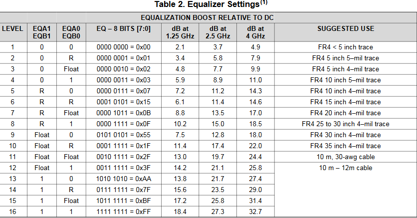

Q1: as below is our EQ configuration setting ,is it adaptive mode(low-rang EQ Gain) for our current setting??
Q2: as your experience,what EQ Gain(high-rang or Low-range) is suitable ??

[EQ configuration]
ADDR_EQ(pin 3)-->PD 4.7K
CAN_Sink(pin 10)->PD 1M

    For question 1, please refer to Table 1 of the SN75DP130 datasheet. For ADDR_EQ VIL and CAD_SNK VIL, the equalizer is fixed but will change the equalization level base on the link training level.
    For question 2, it is system dependent. But if you swap to another cable and can get the flicking to go away and cables are the same, it sounds like you have a bad cable.

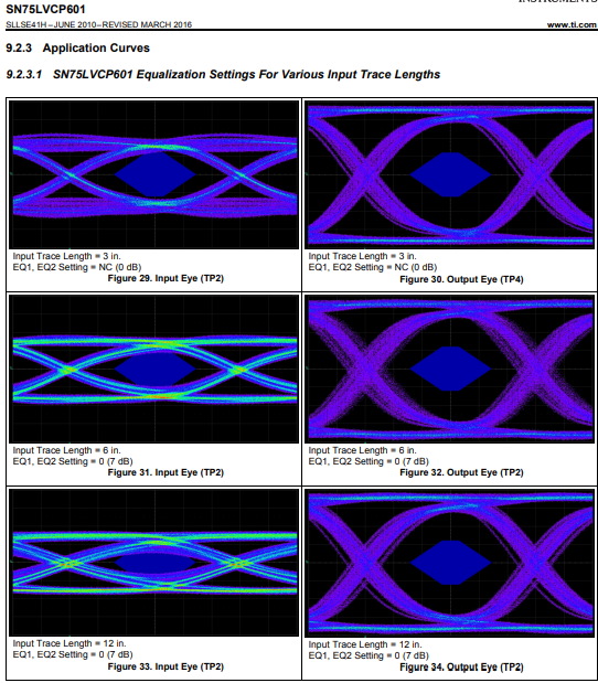

    as use your  other I/F part experience do you have reference data similar as below
    (SATA redriver(sn75lvcp601), PCIe repeater(ds80pci402) for example)
  • David
    Similar data is in section 7.8 of the DP130 datasheet.

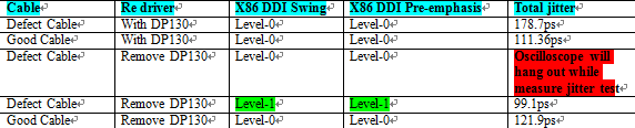

  • Hi David
    thanks for reply, as below is our measurement result , defect cable seem weak than good cable.
    i  try to adjust swing and pre-emphasis from X86 output, then failure symptom will be disappear,
    i will figure out best jitter margin when adjust x86 output or manually change the EQ setting.
