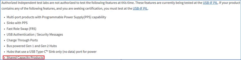

Hi Team
I have question for PD3.0 certification test.
What is the "Shared Capacity products" ?
Is it PD setting or HW Topology ?
Part Number: TPS65987DDJ
Other Parts Discussed in Thread: TPS65987
Hi Team
Hi team,
My customer is testing the USB-IF certification in third party.
They have built their product with our TPS65987 several times and the certification process doesn't face this feedback from third party before.
Because of that third party say if it is share capacity product that my customer couldn't get the cert from third part, only at USB-IF PIL.
Do you know what kind of reason may induce it?
Hi Kerr and Feng,
Can you post the VIF for this product?
I need to research this feature and I can reply back tomorrow.
Scott
Thank you for the VIF information.
I see only Assured power in this device. Also there are no PPS ports. I would ask for clarification from the Lab as to why they believe this is a Shared Capacity Product.
Scott
