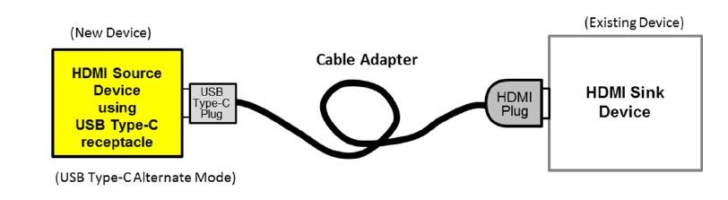

  • Laurence
    Correct, USB Type C does not support DP++.
    The HDMI over Type C spec only defined the HDMI over Type C on the source side. On the sink side, it is still HDMI only as shown in the diagram below.
    If you want to support HDMI over Type C on the sink side, the only solution I see is to use DP and then use an active DP to HDMI adapter.
    David

  • Laurence
    The HDMI cable adapter contains the logic circuit to implement the PD communication and supports the HDMI Discovery Process.
    But even if a PD controller supports HDMI, it will be in the source and the cable adapter, not on the HDMI sink side. HDMI sink side has no concept of HDMI over Type C.
