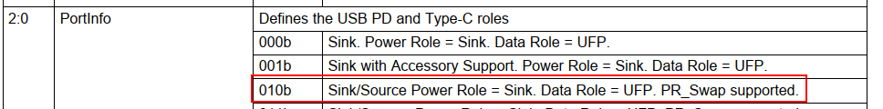

my customer did a design with the TPS65981 PD-controller in operation with a tablet and he is facing some charging issue.
The PD controller should only charge the connected tablet and act as Data UFP (i can share the application Blockdiagram offline); to enable this the configuration was made on register 0x28:
Unfortunately, we now have the problem that the tablet doesn't get charged when it is turned off.
But when I create the below configuration I have the problem that when the tablet is powered on, the Data Role is on DFP instead of UFP; but the tablet gets charged when it is switched off.
Unfortunately, there is no fixed configuration to choose from, which corresponds to Power Role = Source and Data Role = UFP.
Is there a way to enforce this somehow?
